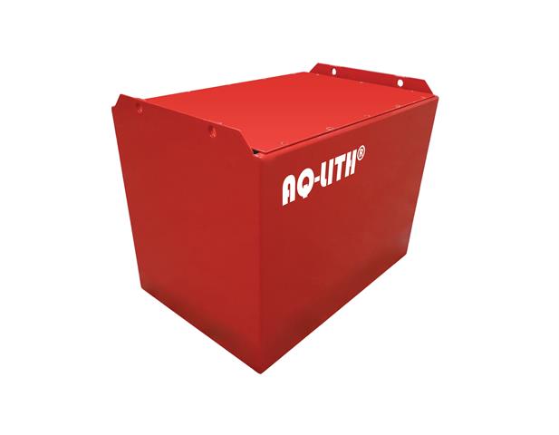

Battery Supplies AQ-Lith lithium-ion battery
Improved productivity and efficiency are often the drivers for new technology and while lithium-ion batteries after a decade on the market can hardly be said to be new technology, the reasons for taking up the technology remain constant. In the US, the adoption rate for lithium-ion technology in the materials handling market in 2018 was 2.5%. The most common complaint about lithium batteries is the high initial cost but, as Koen Bilcke , co-ordinator for Belgium's Battery Supplies Technology Centre, explains, "While the investment of a lithium-ion battery is more than double compared to other traction batteries, if you take into consideration the total energy stored in the battery over its lifetime, the energy throughput is more than four times higher. The energy density of lithium-ion is very high. With restricted dimensions, you can easily increase the capacity and autonomy of your application. For example, due to the low-emission zones in the Netherlands, we see an increased need for electrical cranes in historical town centres. A lead-acid battery can't be used in this application, as it doesn't have sufficient capacity for the job. Lithium-ion batteries have such a high energy density that they can increase the autonomy of the crane for the entire day," says Bilcke .

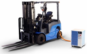

BYD lithium-ion powered electric forklift
One of Tri-lift NC's customers, a food manufacturing plant and warehouse, currently has 24 BYD lithium-ion phosphate battery powered forklifts in operation and another 16 on order. "The customer operated both IC and battery-driven forklifts. Since changing to lithium battery power, his efficiency has increased, with drivers spending more time moving product and less time changing fuel tanks, checking oil or dealing with changing or watering batteries. The customer actually reduced the size of his fleet by 16 forklifts," says Duck.
Bi Guozhong, forklift division general manager for Chinese manufacturer BYD, believes technical innovation will be what will appeal to lithium-ion battery users and converts. "Innovation will contribute to the result of doing more with less for customers. Customers mostly want what is suitable and can solve the problem, while creating value for them," Guozhong believes. BYD was one of the early innovators of lithium-ion technology and has been instrumental in the development of lithium-ion phosphate batteries as well as designing one of the first forklifts to use lithium battery technology. BYD's ECB18C won the 2016 IFOY award for counterbalance truck up to 3.5T. The ECB18C is an 80 v lithium-ion stacker and in the judges' opinion, the forklift solved one of the biggest problems of electric forklifts - operating longevity, as the ECB18C, with its lithium-ion phosphate battery, can be recharged extremely fast, as often as needed and without memory effect, which means it can handle a three-shift duty without stopping.

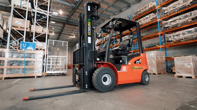

Fork Force all-weather Enforcer electric forklift
Adrian Martin, general manager, quality and product support for Australian-based dealer Fork Force, says that lithium-ion batteries bridge the gap between internal combustion engine forklifts and electric, modified to meet European standards, but because of the reduction in power to meet emission requirements are unacceptable to many operators. "Lithium battery forklifts have shorter charge times, comparable cost of ownership and a safer, cleaner, longer-lasting operation," says Martin. He adds that the ease of charging and the elimination of daily battery maintenance has significant occupational health and safety advantages.
