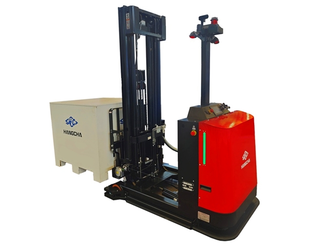

Beyond products like this mini reach AGV, Hangcha is able to help its clients meet the challenges of managing mixed fleets
“Staff need training to work alongside and manage new technology,” adds Zhenyu. “Processes need to be adapted. A gradual journey allows the organisation to learn, adapt, and build internal expertise at a manageable pace, ensuring long-term success.”

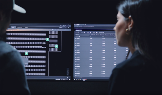

The next step involves investing in a robust, agnostic Fleet Management Software system.
“These system act as a ‘central orchestrator’, capable of receiving tasks and intelligently dispatching all compatible robots – regardless of brand – to optimise overall workflow and efficiency,” says Peng.

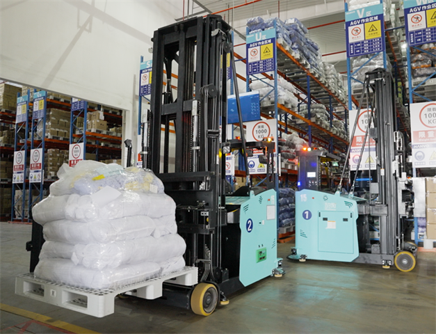

Aaron Zhu, US general manager at Multiway Robotics stresses the importance of safety in the context of mixed fleets and says operators are right to be wary of potential hazards, such as collision risks or system malfunctions.
“To mitigate these, companies typically begin with high-frequency, repetitive, or high-risk workflows where the benefits of automation are clear and immediate,” says Zhu.
“By taking a phased approach, businesses can reduce labour strain, improve accuracy, enhance safety, and build confidence in automation – leading to broader adoption as the technology proves itself.”

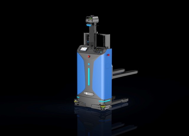

Miya Gong, head of marketing at SEER Robotics, says the fact that industrial environments vary so widely, is another reason so many find themselves with mixed fleets.
SEER Robotics' all-in-one logistics management system connects equipment, such as this AGV, with business systems
“No single provider can offer everything, and no plant uses just one robot. That’s why we offer a complete solution covering development, deployment, and management,” she says.
Given that SEER Robotics offers a leading robot control system and has partnered to develop over 1,000 robot types, Gong is well-placed to make this point.
“These ready-to-use robots can be accessed directly through our Nebula system. For custom development, we also offer over 300 plug-and-play robot accessories, plus developer training and full support,” she says.
To eliminate information silos, the company’s all-in-one logistics management system connects robot platforms with business systems. On top of this, it includes low-code development tools to simplify custom integration and make systems more flexible and scalable.

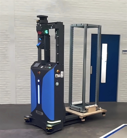

Asked for an example of her organisation’s work, Gong nominates a Philips warehouse in the Netherlands, at which SEER Robotics deployed a flexible and efficient robot solution.
Considering the context, which involved human-robot collaboration, SEER selected the SFL-CDD14-CE stacker robot (which features a 3D camera, distance sensors, and 360° active protection), powered by its safety-rated SRC-3000FS controller and certified with CE and UL.
“We redesigned the workflow, optimised the robot’s routes and pallet positions, and fine-tuned its safety settings. Specific safety zones were set up, and emergency actions could be triggered with a single click – ensuring both safety and efficiency in a complex environment,” says Gong.
As a result of the deployment, transfer speed improved, the need for manual labour reduced, and site safety was enhanced.

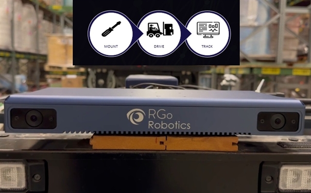

Asked for an example, Fainaro points to RGo’s visual RTLS solution, a machine-level localisation system that makes RTLS implementation feasible for any warehouse, even those with small fleets.
RGo's localisation box retrofits to any moving machine, regardless of make, size, or operation mode (robotic, manual, or hybrid) and requires no significant infrastructure modifications.
Mapping occurs automatically, during normal operations and without disruption, and the solution integrates seamlessly across various environments.
