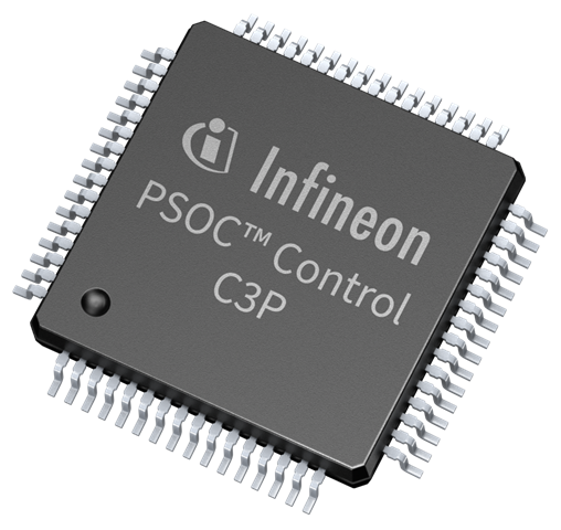

Infineon offers the PSOC Control C3 industrial MCU in TQFP-64 package

While, as a semiconductor manufacturer, Infineon doesn’t offer complete wireless charging systems, its products are key components in their transmitters and receivers. They play an important role in terms of system efficiency, safety, and real-time control – all of which are critical in demanding industrial environments.
“On the transmitter side, our high-voltage SiC MOSFETs (CoolSiC family) are widely used in power factor correction (PFC) and high-frequency resonant inverter stages,” says Pantsirev.
“Then on the receiver side, medium-voltage MOSFETs (like the OptiMOS 5 and 6 families) in the 80–250V class, are used in the DC-DC[1]  stage that regulates battery charging.”

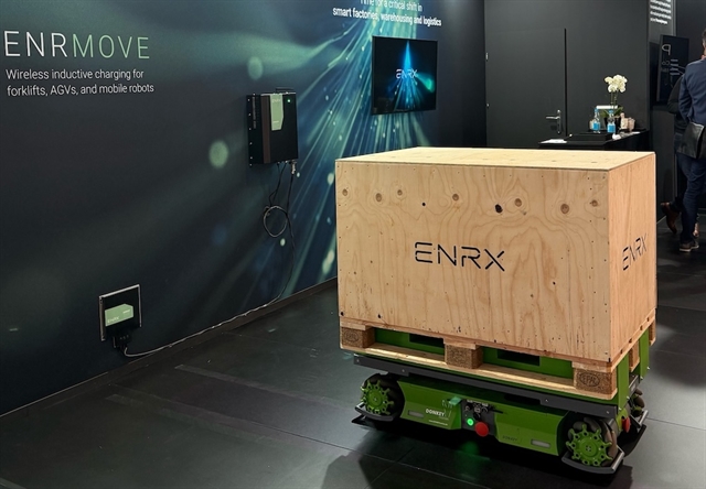

ENRMOVE delivers 3kW inductive power and is purpose-built for opportunity charging

Asked about his own organisation’s offerings in this space, Nishimuni highlights ENRMOVE, a system that delivers 3kW inductive power and is purpose-built for opportunity charging.
“The system is modular, compact and maintenance free. It tolerates misalignment, so integration is smooth in busy environments,” Nishimuni continues.
Technically, it transfers energy inductively. Grid AC (50/60 Hz) is converted to ~85 kHz high frequency AC, generating a magnetic field in the primary coil. Energy crosses an air gap (up to 300 mm) to the receiver on the vehicle, where it’s converted to DC.
Thanks to magnetic resonance, charging remains efficient even when positioning isn’t perfect.

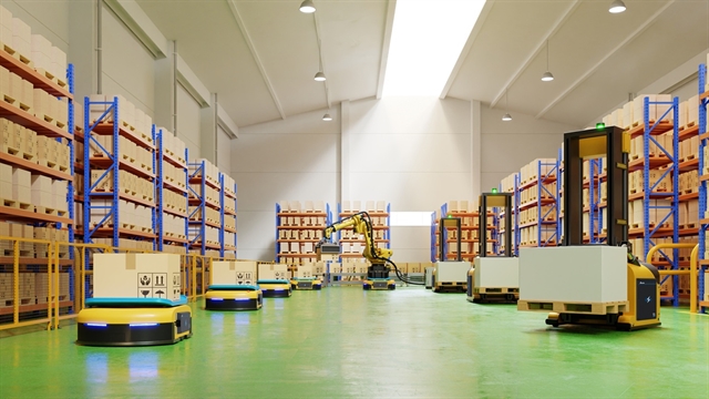

The MOOVair Wireless Charging System is suitable for use with everything from small AMRs to large forklifts
“Inductive charging systems are extremely space-efficient and flexible, making them easy to integrate into existing infrastructures,” says Daniel Dörflinger, general manager of Delta's Industrial and Medical Business Unit.

“The charging pads can be discreetly embedded into workstations or traffic routes, simplifying the expansion of warehouse capacity and the temporary use of additional vehicles, without complex planning or cabling,” says Dörflinger.
On top of this, because the system supports Ethernet-based communication, it integrates smoothly with overarching control and monitoring systems. This ensures that warehouse operations remain scalable, even under changing conditions.
“Inductive charging, therefore, supports not only automation but also the scalability and resilience of modern warehouses,” says Dörflinger.
“In today’s logistics world – where adaptability is crucial – this technology provides a solid foundation for flexibility, without compromising on efficiency or availability.”
MOOVair is designed for growth, with scalable solutions from small autonomous mobile robots (AMRs) to large forklifts and tug vehicles. It offers the comprehensive portfolio-power range (f1kW to 30 kW); and is designed to enable organisations to charge their entire fleets, from small AGVs and forklifts up to tow trucks, inductively.
Thanks to Pad-to-Pad-Link (PPL) communication, it ensures interference-free, secure data transfer, even in dusty or busy environments. In this way, it addresses a key challenge of wireless power in tough industrial environments.

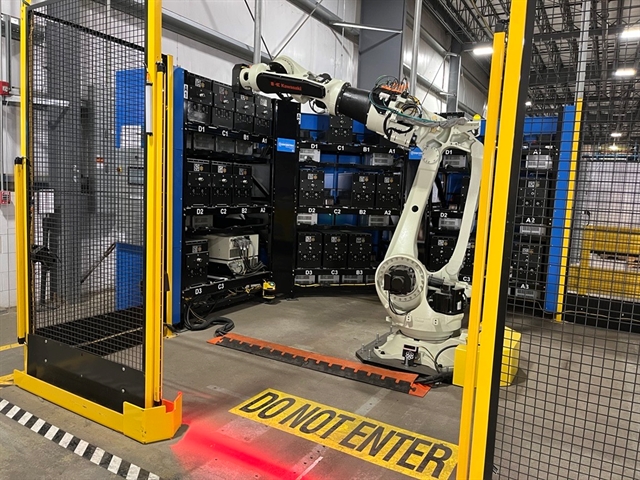

Concentric offers the PowerHIVE system as an effective alternative to wireless charging

In light of this, Concentric offers the PowerHIVE system as an effective alternative to wireless charging.
Shelters uses the analogy of the hand drill to explain the attractions of the system. He says that much like this household item, which generally includes a battery that can be changed simply and without delaying the job at hand, the PowerHIVE simplifies battery swaps.
“It delivers power on demand with 2-minute battery swaps, eliminating peak demand charges and providing continuous uptime,” he says.
Facilitating automated battery changes with no need for software integration, it can be deployed in just three days.
On top of this, it features multi-voltage compatibility across manufacturers, standardised battery sizes, and a push-button operation that removes operators from power management through a central ‘Hive’ system.
But according to Shelters, what makes the PowerHIVE system unique is separation of the power source from the counterweight.
“Unlike wireless charging that retrofits existing batteries to specific chassis, our system lets you buy lithium batteries for their full lifespan regardless of fleet changes, giving you flexibility to change equipment while keeping your power investment,” says Shelters.
As an example, a 36V battery in the PowerHIVE system will power a customer's entire 36V fleet, regardless of equipment type or manufacturer.
According to Shelters, it shows that “the future of forklift power isn't about making batteries wireless, it's about making them instantly available when and where operators need them”.

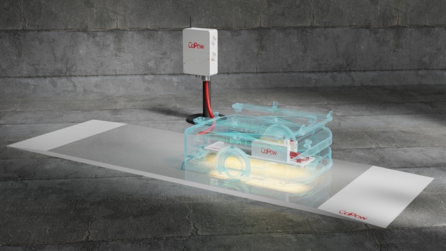

The Genesis system from CaPow is suitable for both AMRs and AGVs

“We’ve developed what we call Power in Motion,” says Peretz.” Unlike traditional charging systems that require robots to stop and dock, our solution uses capacitive wireless power transfer to deliver energy dynamically while they move.”
The solution deploys ultra-thin, modular electrodes – which can be surface-mounted panels or even conductive foil – strategically along high-traffic routes.
Then, when a mobile robot passes overhead, its receiver locks onto the power channel within milliseconds, transferring energy safely and without contact.
“No precise alignment, no interruptions, just continuous power built directly into the workflow,” says Peretz.
Known as Genesis, the system is suitable for both AMRs and AGVs. Capable of 500W energy transfer while the vehicles are moving at a speed of up to 5m/s, it also offers a 50% misalignment tolerance, as well as adaptive tuning for reliable power delivery in real industrial conditions and modular antennas for durability and scalability.
Capow Technology offers Genesis along with it (Genesis Energy Management System (GEMS) for predictive energy management and Energy-as-a-Service (EaaS).
“Together, Genesis and GEMS eliminate charging downtime and turn energy into a managed, intelligent service,” says Peretz.
