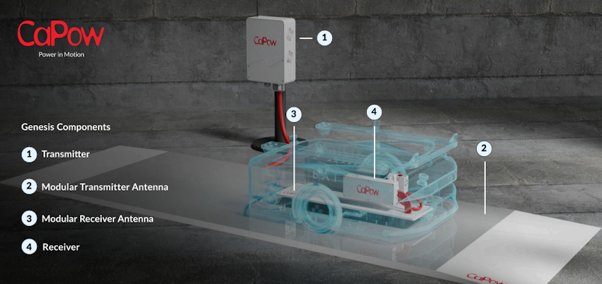

CaPow, a pioneer in efficient power delivery for robotic fleets, has solved this challenge with Genesis, the first and only Power-in-Motion system that delivers energy seamlessly while robots operate. By embedding modular floor antennas in high-traffic zones, Genesis ensures autonomous mobile robots (AMRs), AGVs, ASRS, and pallet shuttles recharge continuously - without docking or interrupting workflow.

Genesis is fleet-agnostic and integrates quickly into both new and existing facilities, eliminating the need for dedicated charging zones. Key specifications include:
  • Rated output power: 500 W
  • Voltage range: 12–60 V DC
  • Current: up to 30 A
  • Efficiency: up to 88%
  • Dynamic movement support: up to 5 m/s
  • IP55 protection rating
  • Operates from –20 °C to 60 °C
Unlike inductive systems, CaPow’s capacitive approach tolerates misalignments of up to 50% of robot size. This flexibility, combined with rapid 10 ms lock-in time, ensures reliable energy transfer even under high traffic and variable routing.
