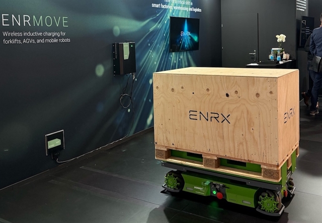

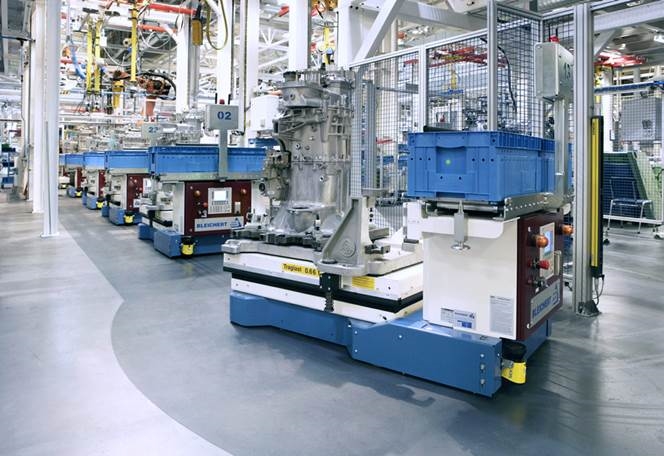

ENRMOVE eliminates the need for separate charging tasks — it happens automatically in the background whenever a vehicle pauses during its routine. Whether at a loading dock, beside a conveyor, or while goods are being scanned, power is supplied smoothly. No plugs, no human intervention, and no lost minutes.
From disruption to integration
Conventional charging needs dedicated stations, scheduled battery maintenance, and operator time to connect and disconnect. Even many so-called “opportunity charging” solutions depend on physical connectors or docking stations that require precise alignment of copper contacts or pantograph heads to enable charging, whether this is done manually or by an autonomous vehicle. In practice, that still involves intervention, careful positioning, and potential wear on exposed parts.
ENRMOVE removes these pain points by making charging invisible. The heart of the system is inductive power transfer: a sealed primary coil, embedded in the floor, mounted on the surface, or fixed to a wall or charging pad, generates a magnetic field when connected to the grid. A receiver coil on the vehicle captures the energy wirelessly, converting it into DC to top up the battery. Because it’s fully sealed and contactless, there are no exposed parts to clean, wear out, or pose safety hazards.

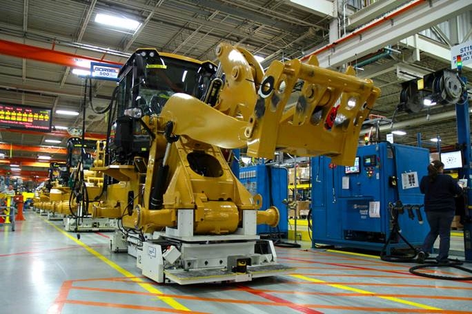

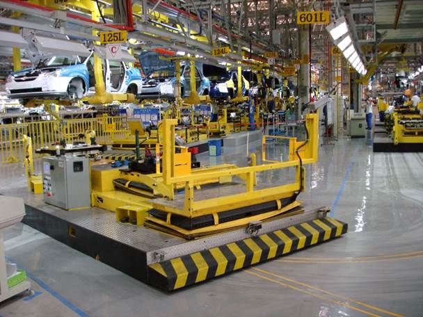

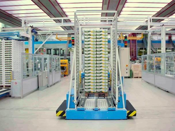

This is proven, industrial-grade technology — not a prototype. Since 1996, ENRX has powered moving equipment such as luggage systems in airports and AGVs in aerospace, automotive, and assembly plants, without physical contact. In 2002, we launched high-power wireless charging for electric buses and trucks — operating at scale years before most on the market.
Today, our systems operate in some of the world’s most demanding environments, from automotive production lines running heavy-duty AGVs around the clock to distribution centres, pharmaceutical warehouses, ports, mines, ferries, and even theme parks with underwater rides. In smart city projects, ENRX builds electric roadways that charge heavy-duty trucks wirelessly at 200 kW while travelling at highway speeds.
