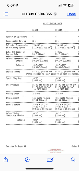

  • Posted 19 Nov 2025 00:23
  • By Rob_Aitken
  • joined 18 Nov'25 - 3 messages
  • Saskatchewan, Canada
Rob
It is a D155g Waukesha the torque is 85-90
Ft lbs for the head as far as the manifold since they are studs tighten to stop then snug you don't want to break those off ! Valve 21 intake 24 exhaust
Here is info
