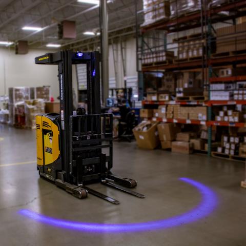

Don Martindale, CEO of Canadian safety products distributor Panacea Aftermarket, sees the avoidance of collisions between a moving forklift and pedestrians as the area of most concern among his dealers. "We all know who will win that battle: the horrific results are just brutal," he says.
Martindale warns that the most common warning system to avoid these accidents - audible alarms - are losing their effectiveness because forklifts operate in noisy environments and also because the human brain is conditioned to eventually ignore repetitive sounds.
Visual warnings, on the other hand, are harder to miss and ignore.

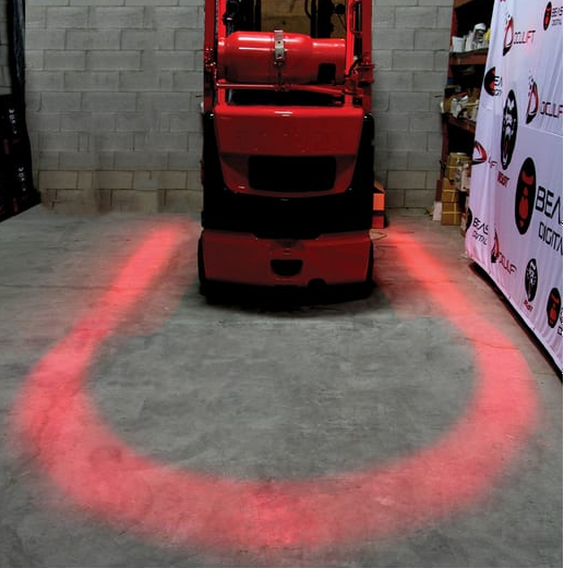

Martindale cites his company's innovative Arc Light as one of the most effective warning options. "It creates a huge U-shaped line around the back and sides of the forklift," he explains, adding that when paired with Panacea's redesigned red zone lights, the system forms a "seamless mobile warning area" behind, on the sides, and in front of the truck.

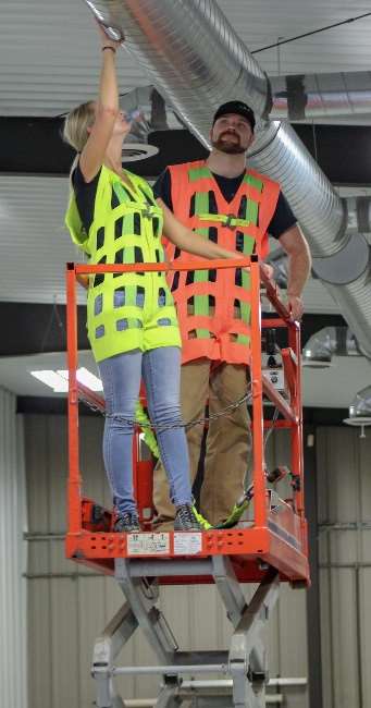

Harnesses are often used for fall protection, especially with man-up lifts and aerial work platforms, and while the existing products on the market may stop falls, David King, president of Warehouse Design, warns that they may not actually save lives.
"The industry standard harness can apply significant pressure to the femoral arteries, resulting in blood clots and/or unconsciousness," he points out. "Although you have initially saved the person's life, they may still experience injury."
Warehouse Design is promoting a new harness design as a significant advance in technology that greatly reduces - if not eliminates - this risk by allowing body weight to be more evenly distributed during a fall. "This new harness also allows more time for proper rescue," he adds.
In addition to being 99% metal-free (and therefore more virus-resistant), the design is more ergonomic and reduces fatigue during wearing.
Best of all, the harness is highly visible. "There can be no doubt from safety management that the harness is being worn even when operation is high up," he insists.

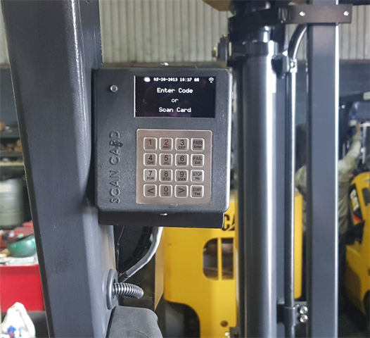

Employers need to demonstrate that their employees have the proper training to allow them to do their job safely, says David Leduc, sales manager of Start-Manager. "That is why unauthorised use of equipment and machines can become a huge safety concern." He notes the challenge of ensuring that only appropriately trained staff can operate equipment.
That's where access control comes into play. Systems like Start-Manager require a key-code or proximity card before staff can operate the forklift. "This allows employers to control exactly who has access to every forklift and machine to ensure that only properly trained individuals can use them. The Start-Manager system completely replaces the key with built-in relays and start/stop buttons."
Additionally, OSHA requires that all forklifts be examined at least daily before being placed in service. The Start-Manager system can be used to disable any unchecked equipment.
"With Start-Manager's wireless reporting feature, employers can also collect and sort all of their safety check reports at a push of a button. Information is securely sent via your existing wi-fi connection to our secure server, and there are never any additional monthly fees," he explains.

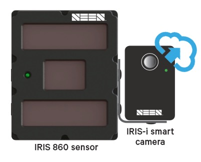

Seen Safety's solution falls into the category of selective detection and is designed to only alarm when a particular item of interest is detected (for example, people or tagged objects) and ignore everything else. This means alarms are less frequent, highly relevant, and therefore more likely to be noticed and acted upon.
Seen Safety's new IRIS 860 LIDAR sensor actively, and selectively, detects reflective tape on high-vis safety apparel, transforming passive tags into part of an active pedestrian alert system for forklifts and other mobile plant.
"Selective detection sensors are great at detection and warning, but when it comes to evidential analysis, and accident prediction and prevention, data is king," he notes. To assist with this, Seen Safety is currently developing a smart camera clip-on module which will automatically upload information about an event to the Cloud, including time and date stamp, a still image, detection position and distance, and the machine and sensor ID.

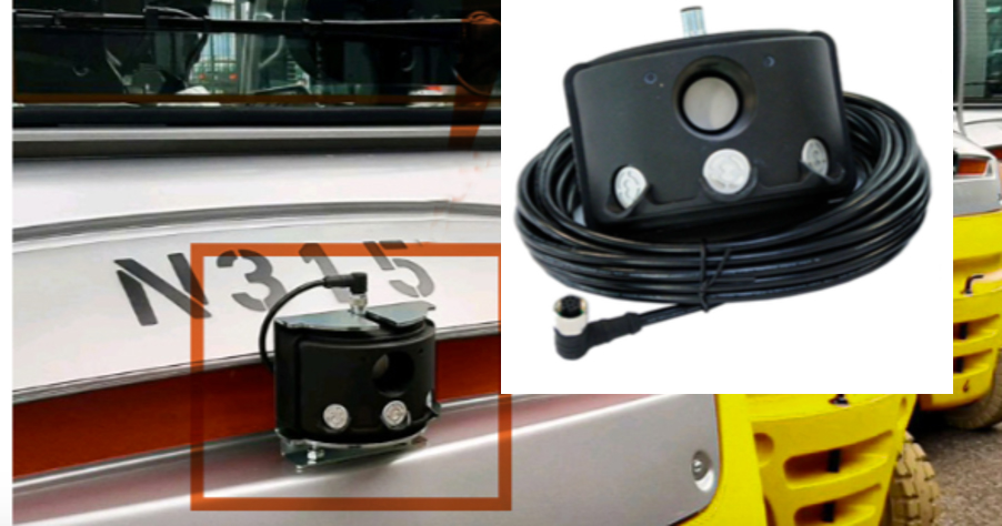

"Basically, they are 'forklift radar' systems which detect objects and slow down the forklift," says VandenTop.

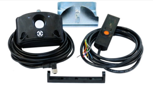

Safe&Alert works like the parking alerts of motor cars, detecting the presence of obstacles when the forklift reverses. This triggers visual and acoustic feedback, alerting the operator about the risk.
When the sensor, placed on the rear part of the vehicle, detects an obstacle, Safe&Stop uses the same detection technology, but in addition to the alarms, the system can automatically reduce the speed of the vehicle, greatly reducing the risk of collision.
"The units have been very popular with companies which have had accidents in their recent past but need an affordable solution," he says, adding that the solutions can be retrofitted for less than USD3,000 per forklift.

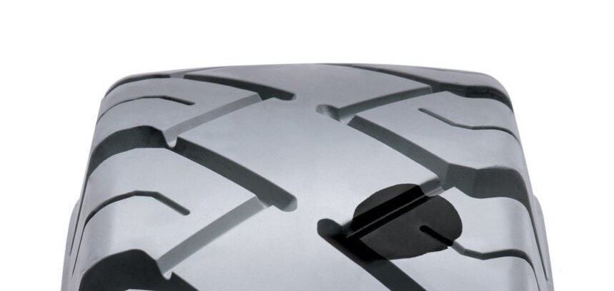

Darren Stratton, product management director - material handling for tyre maker Camso, says his company works closely with OEMs to develop safe, reliable and value-added solutions to equip their machines.
"Collaborating with OEMs is one piece of the puzzle: listening to our customers working in various segments, from warehousing to the paper industry, ports and airport ground handling equipment, is also part of the equation," he adds, citing Camso's non-marking anti-static technology which came from discussions with a client working in the paper industry. "They experienced static issues on their equipment which posed several risks to the facility and operators when their forklifts were running on non-marking tyres. Because non-marking tyres don't use carbon black, the tyres cannot transfer static electricity to ground, leading to static build-up in the forklifts and safety hazards during uncontrolled discharge."
Stratton says tyre wear is among the top safety issues for the industry. "We put a lot of emphasis on operator, technician and dealer education to help reduce the risks linked to running on worn tyres. What damage to look out for, how to assess tyre wear, what are the dangers and safety issues linked to over-worn tyres. In the last months, we developed online educational tools including a free video series as well as a pro tips article to help users identify signs of wear and to share some maintenance tips for maximal life," he says.
