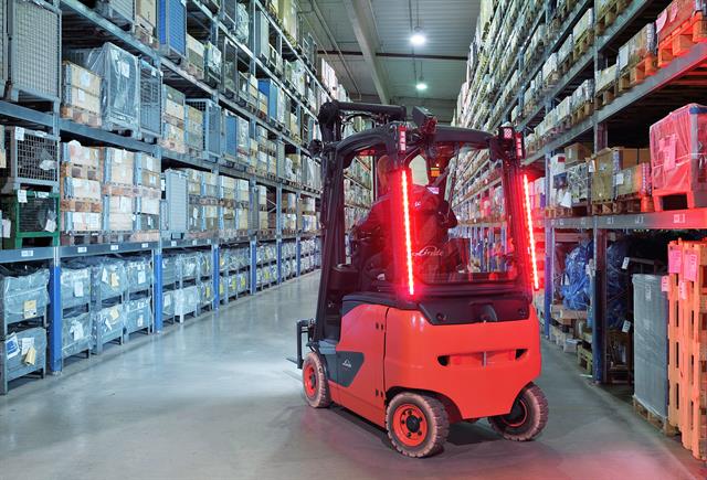

Linde's lighting options include Linde VertiLights and LED Stripes
Marco Dirnhofe, Sales and Service Development Manager for safety products at Linde Material Handling, says health and safety legislation plays a significant role in regulating forklift operation.
"Today, every employer in Europe is committed to conduct a risk assessment for every workplace within the company to determine the risk of certain hazardous substances or activities as quantitatively as possible. When risks are identified, employers have to apply measures to protect their employees from health damage," he explains.
These measures, described as the TOP principle, include the implementation of Technical solutions (like assistant systems for forklift trucks), Organisational measures (like operating instructions, warning signs, signals) and Personal protection (like safety gloves or a safety helmet).
Dirnhofe argues that corporate responsibility plays an increasing role when it comes to safety. "Managers are increasingly aware that safe processes not only lead to a positive corporate image, but ensure the success of the company as accidents harm in many ways: they bring suffering to the injured and their families and can involve high follow-up costs."

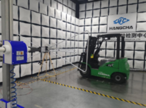

Hangcha XC series electric forklift undergoing electro-magnetic compatibility testing

Hangcha's Xu cites her company's flagship XC series electric forklift as an indication of the safety requirements requested by customers.
Standard features include automatic speed reduction when turning, automatic mast buffering, and automatic fork levelling with a mast designed to increase lateral visibility by 15%.
