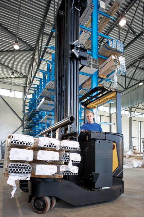

The load weight indicator option in the Cat® Multiway Reach truck helps the driver assessing the situation.

    Most loads are fairly 'inactive', but you should be especially careful with those whose behaviour can affect truck stability. They include freely suspended loads, and liquids in partly filled containers, both of which will rapidly shift their weight from one direction to another if moved abruptly. Insufficiently supported or hastily transported wide loads will similarly 'rock' the truck. Lower your speed, make all driving actions smooth, and carry less than the normal rated capacity.

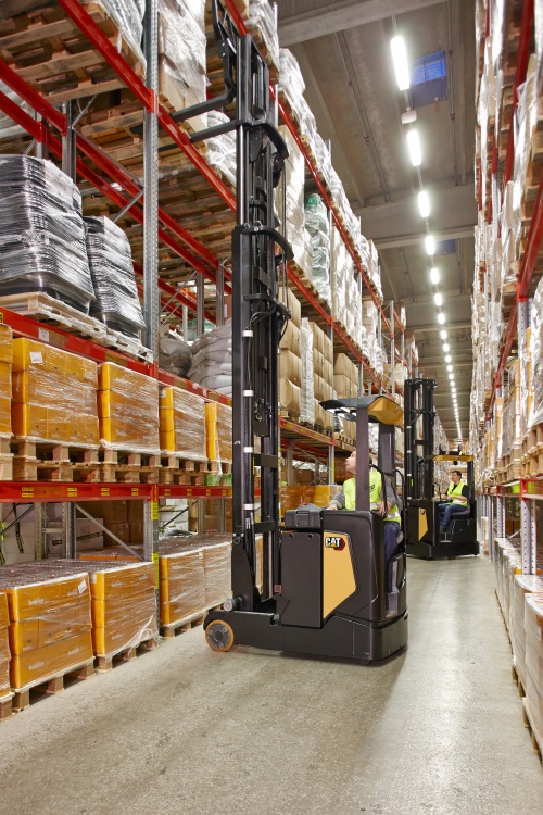

  5. The safety-award winner Cat® NR-N2 reach truck range is a Red Dot Award recipient
