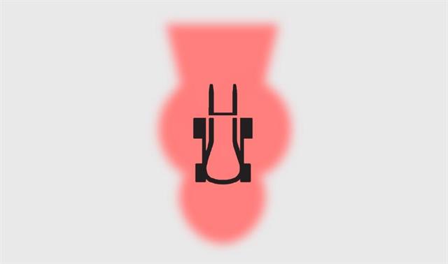

To stop collisions between trucks and people, we needed to develop a safety zone around the forklift however, we couldn't use a generic circular safety zone as it didn't truly represent the critical areas to avoid. So we developed an intelligent safety zone that followed the general shape of the forklift.
Using smart, adaptive warning zones which activate depending on the direction the forklift is travelling in, Safety Guard is able to determine when a pedestrian enters the critical area too close to the forklift - with a position accuracy of 10cm. With an intelligent safety zone established, there are no annoyingly frequent (and usually ignored) notifications that you'd get with a standard circular safety zone - and warnings are only triggered when there is clear danger.
