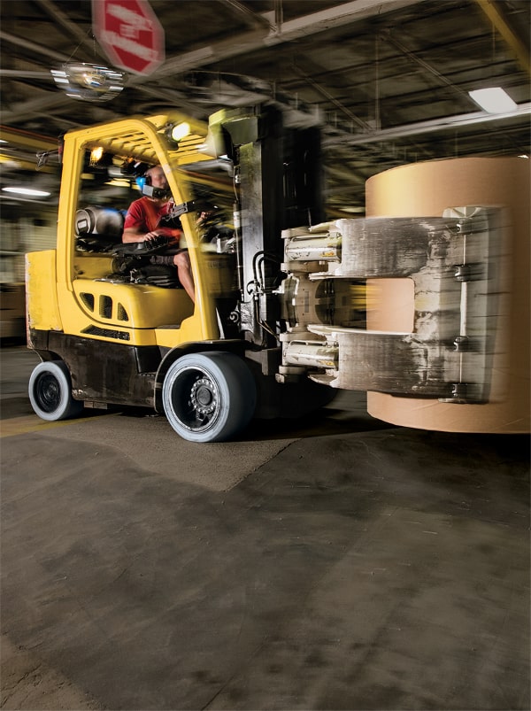

During a full shift of high-speed travel and heavy loads maneuvering, forklifts can store up static charges to dangerous levels. The static charges on a forklift can be strong enough to severely injure a human being. This is why you will often see operators take pains when they dismount to ensure that they break off contact with their truck before they set foot on the floor, sometimes leaping from their seat to avoid a severe static shock. The potential for a slip & fall accident, or for disabling shock causes operator stress, ultimately leads to lack of productivity, another problem that the overall static build-up issue can cause.
Over and above the risks for injuries, facilities handling volatile fumes and chemicals have to be cautious with the forklifts. Propane-powered trucks are vulnerable to gas leaks from their own fuel tanks, as well as gas in the vicinity of a filling station. Paper and textile mills are also subject to the fire hazards of sparking the fine dust that these materials produce. In facilities that handle electronic components, static charges can wipe out circuits, data chips and firmware. Control boards and sensors that are built into the forklift itself, as well as control devices and alarms installed in the facility can even experience a major power outage.

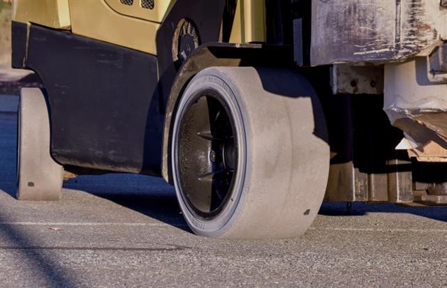

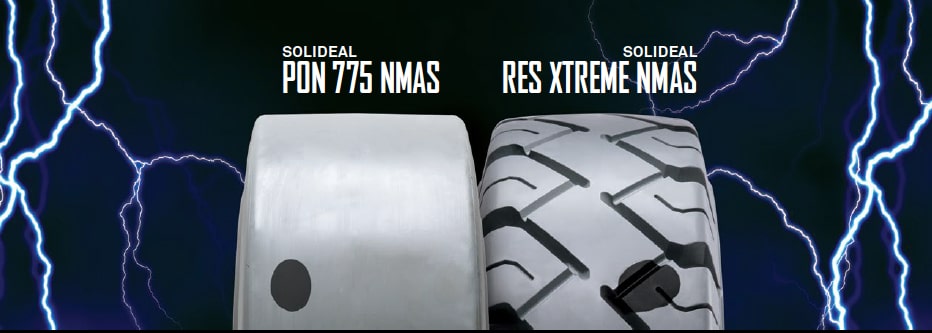

The engineering and product line teams field-tested different prototypes. The final design resembles other non-marking tires, but a telltale dot on the face of the tread shows where a carbon black channel had been integrated through the tire steel band. The tire provides a ground for the forklift when the black dot acts as a "plug" and makes contact with the floor on every rotation.
The breakthrough
Camso announced in 2018 production of the new Solideal PON 775 NMAS, which has now been available through its distribution network. Darren Stratton, Product Management Director - Material Handling claims the PON 775 NMAS is a true breakthrough in tire design: "It's not only the first non-marking anti-static tire, it will also outlast any other non-marking tire. It resists chunking and cutting, resists abrasion, and it virtually eliminates the safety hazards and downtimes of static build-up."
"We couldn't be prouder of this R&D effort," Stratton continues. "Customers who use non-marking tires on high intensity applications tend to have the most intensive material handling jobs: larger trucks, heavy loads, high speed runs, rapid maneuvering. Now they are finally getting an extreme performance tire that checks off all the boxes and provides them with the lowest operation cost solution possible for their applications."
A complete range of non-marking anti-static tires
One year after introducing our patented non-marking anti-static technology with the Solideal PON 775 NMAS, Camso introduced the Solideal RES Xtreme NMAS, a resilient non-marking tire featuring the same innovative technology and thus preventing static electricity build-up. This addition to the line-up makes us the first and only tire manufacturer to offer a complete range of non-marking anti-static forklift solid tires to answer customer's needs around the world.
