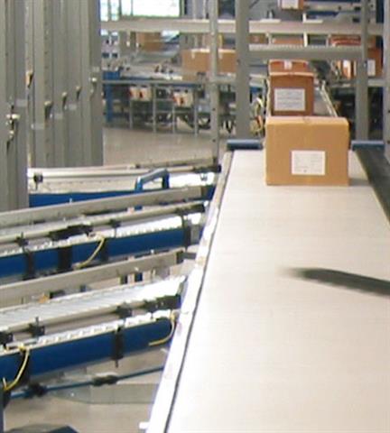

An intelligent system drives productivity and offers agility.
