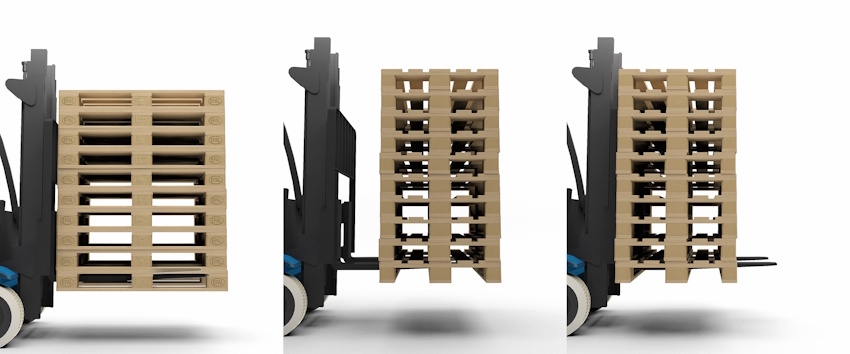

Efficiency is a buzzword in logistics, but how efficient is a standard forklift when it comes to handling Euro pallets? Forklifts are often equipped with forks measuring 1150 mm in length, a length that appears suitable until the pallet is approached from its long side.
Every forklift operator is trained to insert the forks fully into a pallet, ensuring the pallet rests flush against the fork back and providing optimal load stability. This method is also the fastest because the fork back provides a clear visual stop point.
But what happens when a Euro pallet is approached from its long side? The standard 1150 mm forks no longer offer the same level of confidence. The operator must now estimate how far to insert the forks without a physical stop. Under pressure to minimize damage and maximize throughput, this added uncertainty increases stress and the risk of errors.
Telescopic forks offer a simple, effective solution
Meijer Handling Solutions provides an online tool to visualize the actual cost of product damage. The results are precise: in many cases, the investment in telescopic forks pays for itself within one to two years.

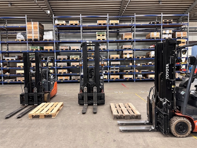

In practical use, the telescopic forks start at 800 mm retracted and can extend to 1200 mm. This allows operators to always insert the forks fully into the pallet regardless of orientation, keeping the load stable against the fork back. This eliminates the risks of:
  • Damaging rear pallets from over-penetration
  • Insufficient fork support causing forward tipping
  • Load shifts due to partial entry
  • Wasted time correcting alignment errors
  • Larger turning radii when maneuvering
With telescopic forks, operators can handle pallets more quickly and with less stress.
