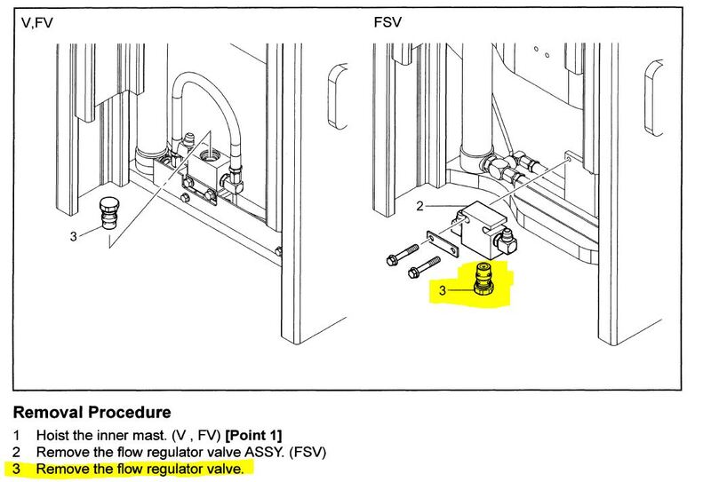

I'm dealing with an issue on one of our machines that I hope someone has some insight into. Out of the blue the mast on the machine started lowering painfully slowly. Every other hydraulic works normally except for the lower function. Doesn't matter which height the mast is at, it always comes down at a rate of about 1-2 inches per minute.
I have swapped the lift/lower & tilt switch (unit has mini levers) to rule out a bad switch. It did not change. I pulled the entire valve body out of the machine and checked all of the solenoids and ports and plugs on the lift/lower control valve. I saw somewhere in the forums mention of a broken spring behind the flow control valve. No broken springs and no plugged or blocked orifices that the manual said to check.
While the entire valve body was out, I swapped the lower solenoid assembly with the raise solenoid assembly since they're the same part and it would be easier to swap the raise solenoid assembly if that was the issue after the valve body was installed back into the machine. Problem stayed after swapping.
I've checked the safety down valves and the flow regulator valve and they seem to be working as they should with no obvious broken of collapsed springs.

Thanks for replying. I have heard the term velocity fuse before. Would this be the mechanical fitting that screws in line to the bottom of one of the lift cylinders? Is it also called a (safety down valve)? I attached a couple photos of the valves I visually inspected. I followed the pressure line to the flow regulator valve first. I removed this valve to see if the spring was still intact. It was, but I bypassed the assy with straight through fittings and there was no change. I also removed the safety down valve at the bottom of one of the 2 2nd-stage pistons. That spring and operation on that fitting also seemed to be operational.
