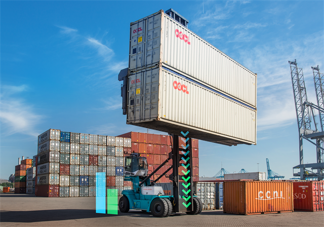

A Konecranes container handler
Manufacturers such as Konecranes are coming up with innovative ways to reduce fuel consumption. As part of Konecranes’ ‘Ecolifting’ solutions, the company has been improving the engine efficiency of all its models, including reachstackers, forklifts and container handlers.
The changes, which include a new hydraulic system configuration and customised pump set-up, together with an optimised driveline, and a new transmission design with a lock-up function, deliver the same power with 15 to 25% less fuel.
While the emissions from these engines obviously remain higher than emissions from electric vehicles, this is nevertheless a significant reduction, and according to Konecranes, the most cost-effective way to start reducing emissions and fuel expenses.

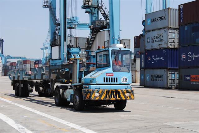

Other companies are working on reducing emissions in ICE vehicles through innovative air conditioning technology. French company SNDC, which specialises in electric air conditioning units, offers immediate solutions that can be implemented in ICE equipment to reduce emissions.
David Massat, sales director OEM and export, explains: “During loading and unloading operations, the driver often keeps the engine on for thermal comfort inside the cabin. Our Stop & Comfort system, which is directly connected to the batteries of the vehicle, allows the driver to benefit from the same thermal comfort when the engine is off.
“For terminal tractors, we estimate that the loading and unloading time covers roughly 30% of the activity of the machine. With our solution in place in addition to the original aircon system, drivers can turn the engine off but still stay cool; this results in a 30% reduction in emissions.”

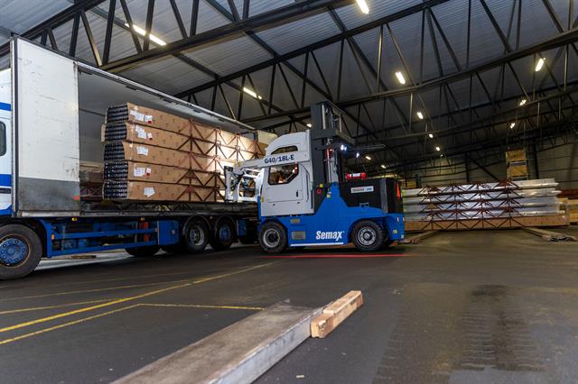

Tobias Ingemarsson, CEO of Swedish company Semax, notes that technology can extend the capacity of electric forklifts without adding emissions. “We have produced electric forklifts up to 15 T since 2003 and we have learned many things on the way.
A Semax lithium-ion forklift in action
Ingemarsson cites his company’s "extension", a heavy-duty bolt-on attachment that fits over the existing forks to extend the reach. “By doing this, the driver doesn’t need to move the forklift – only the arm system. The result is reduced electricity consumption as only the pump motors need to be used to make the final adjustments during loading and unloading.
“With our electric drive line together with our in-built extension, we can reduce the environmental impact to almost zero,” he explains.

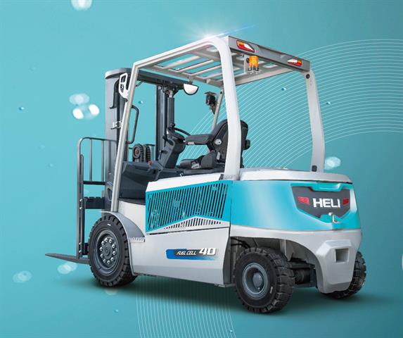

Fuel cells.  Hydrogen fuel cells are a relatively new technology that is likely to have a place in the materials handling industry in the future. Hydrogen fuel cells produce clean energy with only water and heat as by-products, can be charged much faster than a lithium-ion battery, and operate well in cool conditions. At this stage, challenges remain regarding storage, distribution and production of hydrogen, and companies with smaller fleets may not be able to invest in the required infrastructure.
Heli's hydrogen fuel cell forklift
However, Chinese companies Heli and Hangcha are powering ahead with development in this area. Heli is currently selling 2 to 3.5 T hydrogen-powered forklifts in small batches. Hangcha has been researching hydrogen fuel cell technology in forklifts since 2016, and successfully launched two series of hydrogen fuel cell forklifts in 2019. “Our trucks can deliver the performance of an ICE truck in terms of productivity and efficiency, alongside benefits from reduced noise levels, zero emissions and a low total cost of ownership,” Zhang says.
