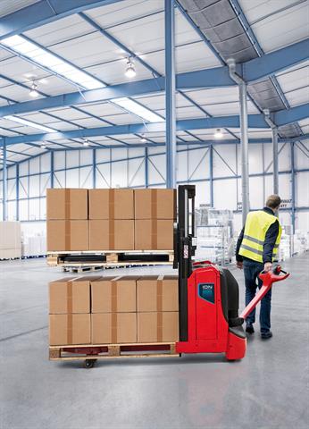

The T16L ION pallet truck and the Linde D08 ION double stacker are powered by lithium-ion batteries.
Melissa Barnett examines the rise of new energy sources, how they address many of the recurring problems of the old technology and whether they are really here to stay.
In the usual way of change and innovation, what were once new energy options for materials handling equipment are now almost standard. Lead acid batteries are still popular and widely used, but they are beginning to feel like they are getting closer to their use-by date. Equipment manufacturers are already designing forklifts of the future that build lithium-ion (Li-ion) capacity straight into new equipment. Linde senior vice-president - product management Stefan Prokosch says that his company is working on designs that adapt to the ergonomic potentials of Li-ion. Maxime Vidricaire, chief business officer for Canadian battery manufacturer Stromcore, says that OEMs are looking to maximise performance by designing forklifts with the counterweight outside the battery compartment, allowing the maximum number of lithium modules to fit into the allocated space.

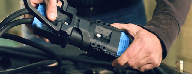

Eaxtron battery connector
Alexandre Bourdy, international sales manager for French battery connector manufacturer Eaxtron, says there are quite a few reasons for people to look for alternative energies, but the main one is efficiency - in use, cost and maintenance.
"With new energies, companies aspire to use their trucks almost 24 hours a day, seven days a week without having to replace their battery and with shorter charging time," says Bourdy. He believes safety is the second top reason. Prokosch agrees and explains that lithium-ion battery technology has distinct advantages, especially for customers with multi-shift or energy-intensive applications. In addition, unlike lead acid batteries, lithium-ion batteries create no potential battery gases during the charging process.

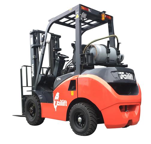

Tailift PFG25
Tailift PFG25
James Kuo, product planning director for the Tailift Group, believes Li-ion batteries are the most successful new energy because it is a mature technology already adopted in various other industries. "I believe in a few years, as the supply for Li-ion increases, the price difference between lead acid and lithium will reduce dramatically, and eventually Li-ion will replace lead acid as the standard - much the same as LED technology has replaced CRT in the television market," says Kuo.

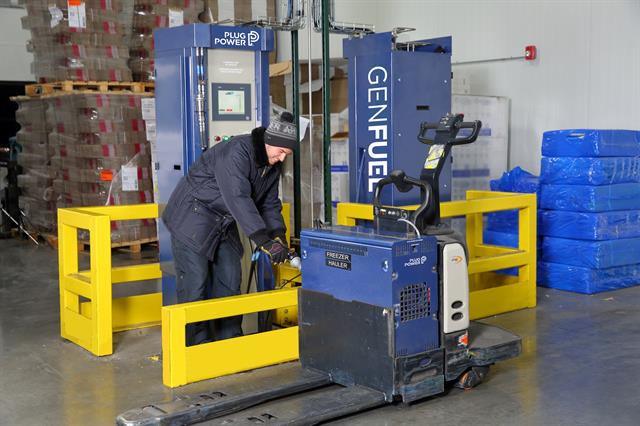

Plug Power Freezpak refuelling
Marsh says that Plug Power recently signed an expanded deal with US retailer Wal-Mart to supply 30 additional hydrogen fuel cell solutions, over three years, across Wal-Mart's North American distribution centres. Wal-Mart currently operates 6,600 units, the largest fleet of hydrogen powered vehicles in the world. This follows an earlier USD600 million deal with Amazon to trial hydrogen fuel cells in 10 of its US warehouses. "End-users have embraced them because they can see the ROI on Plug Power's hydrogen-based solutions - cost savings, smoother operations, increased performance and synergies with the broader goals for their business," says Marsh. Wal-Mart has been able to grow and maintain the largest fleet of hydrogen fuel cell-powered electric vehicles in the US retail industry. Jeff Smith, senior director of logistics maintenance and purchasing services for Wal-Mart, believes that Plug Power's materials handling solutions represent a critical component in Wal-Mart's supply chain."Hydrogen fuel cell technology, coupled with Plug Power's innovative fuelling stations, has proven to be a reliable, cost-effective alternative to traditional energy solutions," says Smith.
"We see a growing market opportunity for our power and fuelling station technologies within the materials handling segment, as well as new mobility applications worldwide," says Marsh.
Prokosch says Linde have been offering hydrogen fuel cell units as customised options since 2010 and that hydrogen fuel cells impress in many ways: refuelling times of just a few minutes, low maintenance, zero emissions in operation, and high efficiency in both full and partial loads.

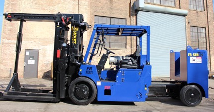

Hoist manufactures electric forklifts to 25T
Colleen Burke, marketing co-ordinator for US manufacturer Hoist Liftrucks, says that they have received more enquiries about electric forklifts in recent years and, for this reason, Hoist has added four new electric-powered forklifts to its product line, one with a lifting capacity of up to 25 T. "The use of alternating current (AC) in high-capacity machinery has come out of the shadows cast by direct current (DC) electrical energy recently. This technology has been around, but is newer in the 7 T and above machines that Hoist manufacture. AC has proven to be more effective in our machines due to lower maintenance costs, such as elimination of wire brushes used in DC, and a longer life-span," she explains.

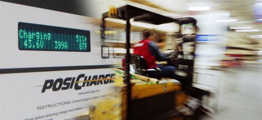

PosiCharge systems from AeroVironment Inc are being used by Nestl�.
Flores believes that the electric solution is a solid value proposition currently and the prime energy sources are reliable and predictable. "Innovations like automated guided vehicles and cheaper lithium solutions will keep lowering the bar for converting to these technologies, eventually establishing electric vehicles as the standard moving forward."
