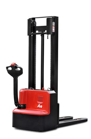

Pedestrian forklifts effectively replace the need for humans to lift and carry. Huang Xiaoping, director of Hangcha Group's Warehouse Equipment R&D department, believes the rising cost of labour in his region and the rapid development and increasing needs of the logistics sector have resulted in "great growth for pedestrian forklifts in the last five years".

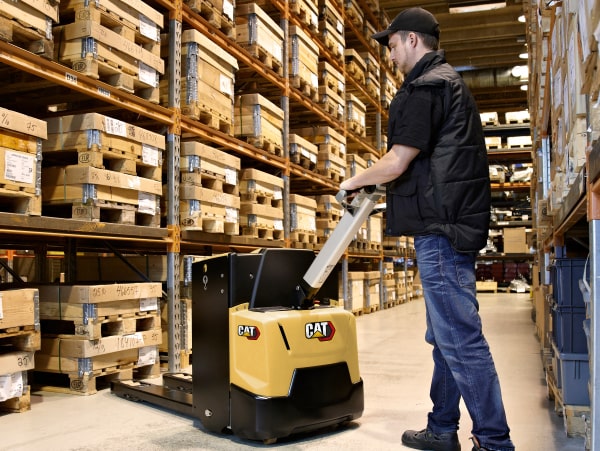

The rapidly changing landscape for pedestrian forklifts, particularly in the e-commerce sector, has meant that operations using traditional manual pallet forklifts are switching to mechanising the operation with powered forklifts, resulting in improved efficiency while reducing fatigue and repetitive strain injuries. "The e-commerce working environment is typically fully automated but eventually some manual operations are required like packing stations and bulky goods difficult to automatically store and pick. These operations are often equipped with an electric-powered pedestrian forklift; they are not intensively used but still need to be around for moving goods to the right location," says Jan Callderyd, manager of product planning for Cat Lift Trucks.

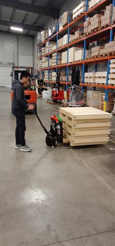

Due to the falling cost of efficient, lithium-ion batteries, the switch from manual to electric pedestrian forklifts makes good economic sense. The improved technology also means that pedestrian forklifts can be used in increasingly diverse applications. Maxim Khabur, marketing director at battery supplier Onecharge, says his company's 4,500 lb. (2,000 kg) pallet jack series lithium battery is a case in point. "These slim, light but powerful batteries house in their narrow bodies an internal 110 v charger, carry enough energy to last a pallet jack through the day and allow for a frost or seal package upgrade. The batteries come with a wash-down package created specifically with meat-rendering operations in mind, when batteries have to withstand daily cleaning with chemicals and pressure-washing," says Khabur.

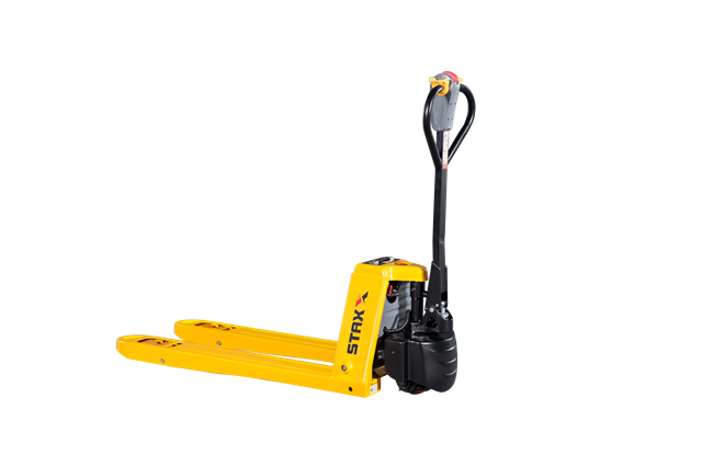

As Thomas Wang, sales director at STAXX Material Handling Equipment, says: "New products are born from demands" and pedestrian stackers are ideal for customisation. Workplace health and safety are often the motivation for technological improvements. STAXX's electric lithium EPT 15h/18h pallet trucks are built with an onboard driver training mode which allows the operator to set the equipment at a speed of 1km per hour for training purposes. If the speed is exceeded, the alarm sounds and the equipment stops. The setting also allows the handle working zone to be reduced so the operator can only lift or swing to a prescribed height and area until comfortable with operating the equipment at full capacity.

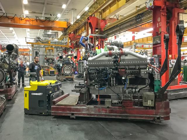

Technology integrated in the latest generation of pedestrian forklifts has opened up more applications to them; however, this has also created a greater need for safe handling during use. With this in mind, says McVicar, Combilift has developed a high-capacity powered pallet truck, the Combi-PPT. "Our customer, Cummins UK, which handles engine units, required a pedestrian forklift to carry immensely heavy and potentially dangerous loads safely from production area to the testing and despatch area. We designed and built a high-capacity walk-behind pallet truck, the Combi-PPT, with 16,000 kg capacity power steering, dual rear wheel drive and AC motor technology. The pedestrian pallet forklift with its manoeuvrability around tight corners make it effortless for operators to move the heavy and very valuable loads safely and with ease," says McVicar.

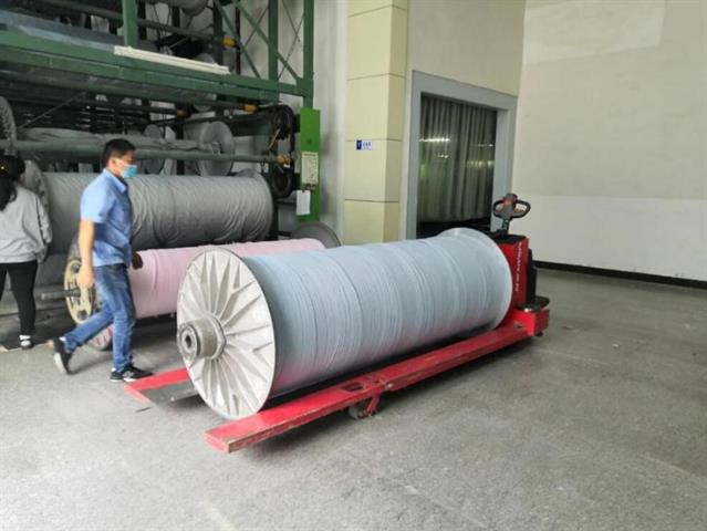

Heavy industry is a sector that regularly sees pedestrian forklifts adapting to requirements. In the non-ferrous metal industry the transfer of heavy aluminium coils can be achieved efficiently and safely says a MIMA spokesperson, with the MIMA straddle stacker. The customized 0.5T-3T stacker has widened legs for increased stability and the mast has been adapted for wider vision. The straddle stacker can be further adapted for handling paper coils, steel coils, round steel components and other similar circular coils and comes in a lithium battery option.

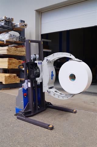

Customised attachment solutions are designed to enhance the functionality of existing equipment. Like other forklift models, pedestrian forklifts are able to have a multitude of attachments added to them. Mike Yacks, global product manager for Cascade Corporation, says that Cascade's products are designed to enhance the functionality of these movers, giving operators greater capabilities while still being able to work in small spaces or with challenging and unusual loads. Smaller attachments, he says, are a great solution for pedestrian forklifts in warehouse businesses, responding to the increased demands of e-commerce. Cascade's 3H Paper Roll Clamp is one such solution. "The ultralight capacity roll clamps are ideal for packaging and converting applications where small rolls of speciality material, such as blister wrap, are too large for a person to handle but too small for typical handling equipment. Often these applications include stationary equipment or clean environments that impose space restrictions," explains Yacks.
