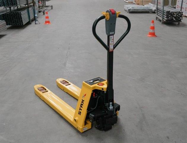

This is one of the reasons why the electrically driven and also lifting version has been developed that bridges the gap between the hand pallet truck and the full size industrial electric pallet truck. The Chinese brand Staxx is following this trend and, with the EPT15H, is bringing a light, good looking electric pallet truck onto the market. Solidly built and equipped with all sorts of useful features.
48V LITHIUM-ION

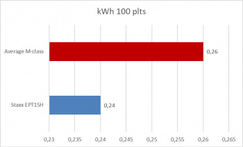

Unlike many competitors, the Staxx EPT15H is not equipped with a 24V, but with a 48V battery. It is powered by a lithium-ion battery that can easily be changed as a small block with a handle. Just disconnect the mini-plug and you take it out with a simple arm movement. Thanks to the efficient brushless DC motor the energy consumption is so low that we cannot register it with our energy meter. Of course, the truck consumes energy, but in order to estimate the amount, we have to refer to the battery indicator on the handle. Based on the discharge rate, we arrive at an estimated practical deployment time of 4 to 5 hours, which is pretty good with a battery capacity of only 10Ah. If you want to work longer, simply change the battery for a fully charged one in just a few seconds. Charging the battery with the very compact charger is quick and easy, also possible when the truck is transported by a trailer or lorry.

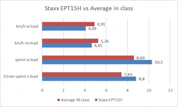

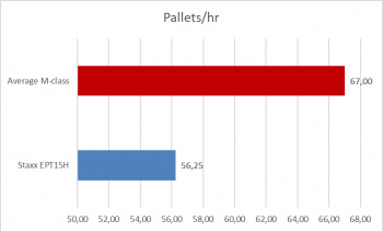

While working on our test track for electric pallet trucks, we don't notice any problems with the heavy load that we have reduced by about 50 kg. What we do see, however, is that the Staxx shows modest performance in all tests. The acceleration with and without load, the driving speeds and the number of pallets moved per hour, everything is done in a relative peace of mind, but with conviction. Never do we have the idea that the truck is on its limits. According to the manufacturer speeds can easily be increased by changing the controller and motor settings. In exchange for the modest speeds, you get a favorably low energy consumption and an attractive operating time.

When working with Staxx EPT15H, we also try the penetrating power in pallets with a half or fully closed pallet. According to the manufacturer this would be an advantage and that is true as long as there is some weight on the pallet. In the case of unloaded pallets, we do not always experience the advantage of the special, angled fork tips. With some lifting of the fork, picking up and dropping off is noticeably better.
Furthermore, we experience the closed back of the forks as neat and sufficient to prevent damage to shoes and feet. The push rods for operating the tandem wheels look solid and appear to come from heavier electric trucks. The rather sharp edge between the handle and the closing cap is seen as a preventable sloppiness.
