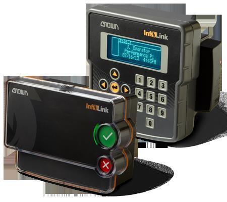

Jim Gaskell, director of global technology business development at Crown Equipment Corporation, observes that because of its role and close proximity to warehouse activity, the forklift is emerging as one of the primary data collectors in the warehouse. "Crown envisions a connected warehouse in which the forklift becomes not only a roving sensor that reaches parts of the warehouse no other system is reaching, but is also a hub that collects data from various other devices, acts on this data, and consolidates and analyses it for other systems.
Crown's InfoLink
Crown's InfoLink
"We're already doing some of that through the Crown InfoLink wireless fleet and operator management system which gives managers the forklift and operator data they need to make better business decisions and achieve better return on investment," he adds.
