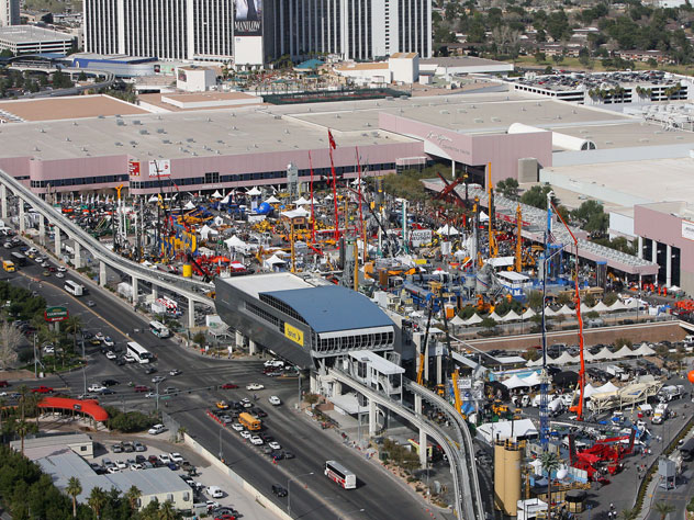

Conexpo-Con/Agg 2008 in Las Vegas
The biggest and the best in telehandlers were recently on show at the largest trade show in North America, Conexpo-Con/Agg 2008. Organised by the Association of Equipment Manufacturers (AEM), the Las Vegas construction and agricultural expo covered over 2.293 million sqft of exhibit space, boasting the very latest in telehandler technology and design. Christine Liew looks at some of the new telehandlers for the construction industry.

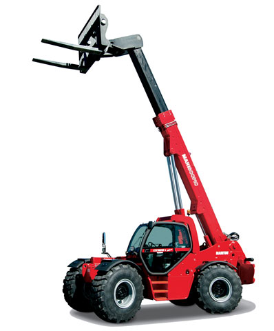

Manitou's MHT 10210 telehandler
The MHT 10210 that offers a 46,000lb (20,865kg) capacity and 31'9" (9.7m) lift height has many of the same features as the MHT 10160 but with differences in base truck capacities. It has a 28,600lb (12,973kg) capacity at its maximum lift height and a 11,000lb (4,990kg) capacity at its maximum forward reach of 19' (5.8m).
