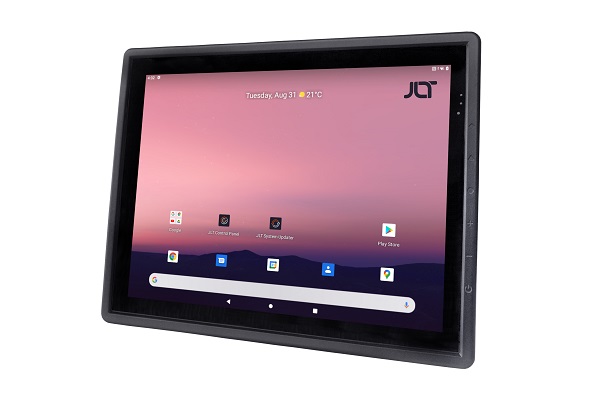

JLT Mobile Computers, with headquarters in Sweden and the US, has designed rugged mobile computers which can be retrofitted to any forklift, regardless of power source. The JLT6012 series has a large range of integrated sensors, collecting data and managing everything from the forklift’s acceleration, direction, battery voltage and current, ambient light and temperature to fuel consumption and servicing requirements. Christian Funk, director of business development, says that the JLT6012 series was designed to adapt to a variety of environments including warehousing, transportation and ports. The integrated sensor technology makes it possible to create software that can help the user or manager to keep track of the devices, the forklifts and the drivers. “Integrated sensor technology can bring endless advantages,” says Funk. “Take in-vehicle safety, for example. We can create software that blacks out the screen when the forklift is in motion. This removes the risk of a driver being distracted by looking at the screen while driving and causing an accident. The same sensors can be used to alert drivers to environmental conditions such as vibration and shock.”

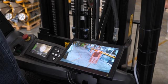

Lucia Minervino, spokesperson for Kiwitron, says that working with clients on specific application needs has resulted in innovation designed from experience. Kiwitron’s Kiwi-eye artificial intelligence detection system for pedestrians and forklifts was born out of the need to invest in safety, while maintaining high standards of productivity and efficiency. The Kiwi-eye system continuously processes real-time streams of video data to detect objects in the environment, eliminating the need for pedestrian tags. Advanced algorithms ensure personal information is not captured. Kiwi-eye detects pedestrians and forklifts within a field of up to 25 m and within centimetres. When an obstacle is detected, Kiwi-eye immediately alerts the driver with an acoustic and a lighting signal with three alarm levels – alarm, warning, safe. The system detects markers positioned in specific areas or above machinery to recognise specific objects and the driver is not only warned to avoid but, if Kiwi-eye is integrated with a control unit on board, the forklift can be programmed to automatically slow down. Kiwi-eye can also be integrated with Kiwitron’s Fleet Management ETS system to make a near-miss analysis and add functions such as: fleet localisation, shock sensor, parameters monitoring, data storage, access control, mission management, analysis and reporting.

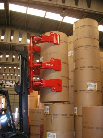

Innovation doesn’t always mean developing something new; often it is making an existing product work better. Carlo Fallarini, global marketing manager for the Bolzoni Group, believes real innovation happens by improving either product performance which results in better productivity and safety or by developing a new way of doing something. Bolzoni’s electric-operated attachments have taken their inspiration from the real world to develop innovative solutions, according to Fallarini. The “Intelligent” CTX range of clamps are fully computerised and automated with integrated clamp testing to ensure minimum clamp pressure – taking the guesswork away from the operator and avoiding out-of-roundness caused by excessive clamping force. The new technology also allows for integrated information to be available to both the logistics manager and the operator, minimising risk.

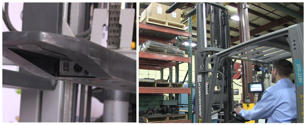

Safety and efficiency are big drivers of innovation, and Arnold Vetter, CEO of VETTER Industrie, says these goals create breakthrough solutions. VETTER's SmartFork technology, an integrated management system, was designed to enhance both. Starting with an integrated camera in the forks, Vetter realised that additional features could be installed such as sensors for measuring distance, occupancy, weighing and incline. “The real challenge was to make these components industrially stable and ergonomic, thereby enhancing efficiency,” says Vetter. VETTER SmartForks can be customised to suit requirements with a range of sensors assembled as per the customers' specifications and all can be fully integrated. SmartFork Flash is a simple but effective safety feature consisting of a set of LED strips attached to the inner and outer sides of the forks. The strips on the inner side of the forks display the entry depth into a pallet for efficient and safe load pick-up. The outer strips have programmable lights for visibility in dark or unclear environments and indicate the length of the forks, visible from a distance.

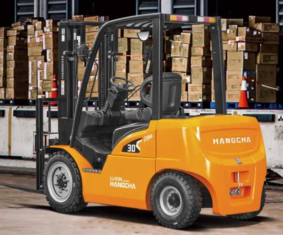

New and improved energy sources have long been an innovation goal for forklift manufacturers. Chinese forklift manufacturer Hangcha has developed the XH electric forklift series which is a low energy use forklift, employing a permanent magnet synchronous system on the basis of a high voltage (309 V) platform. Eric Cao, product manager for Hangcha says that the new system has the advantages of high efficiency, high torque, small temperature rise, small size and low failure rate, which greatly improves the performance and reliability of the product. Compared to traditional electric forklifts, Cao believes the HX can save up to 20%-30% of energy costs.
