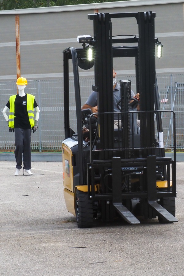

Application of our product on a newest forklift model of our partner and dealer CGM CAT Lift Trucks.

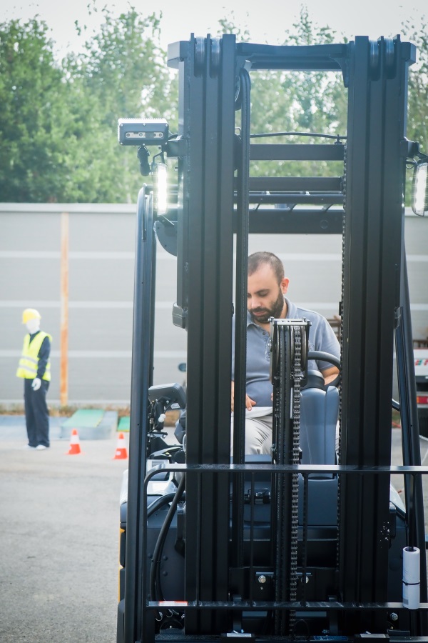

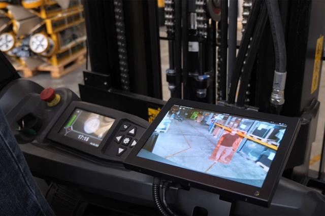

Kiwi-eye is able to detect both pedestrians, forklifts and markers with a high degree of accuracy and selectivity. The camera uses sensors with high standards of responsiveness both indoors and outdoors.

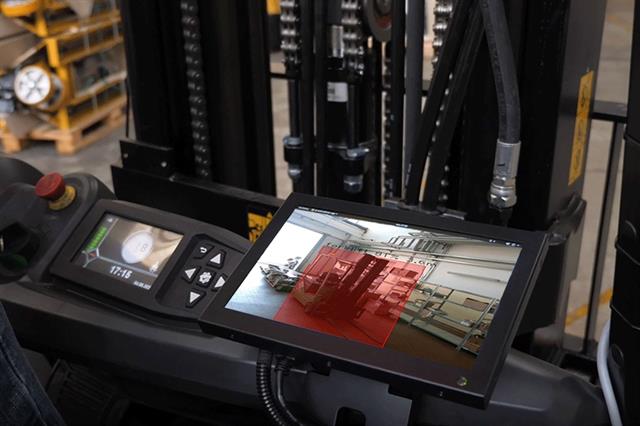

How does it work? The system continuously processes real-time streams of video data to detect objects in the environment. Thanks to advanced algorithms, personal information is not captured. Kiwi-eye detects either pedestrians and forklifts with a detection field up to 25 meters and measures distances within centimeters. When an obstacle has been detected, Kiwi-eye immediately alerts the driver with an acoustic and a lighting signal. There are three alarm zones (alarm, warning, safe) that can be set up according to the running signal of the machine.
The system interfaces directly with the machine, it's easy to install, set up and use. Kiwi-eye is more than an additional accessory: it's a driver assistance system that adds a competitive value to businesses.
What Kiwi-eye sees: pedestrian and forklift detection on board.

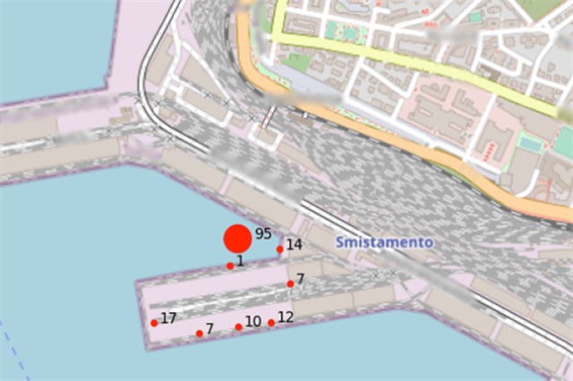

The red points indicate near misses: the number 95 are the near misses that have taken place in a cargo ship.

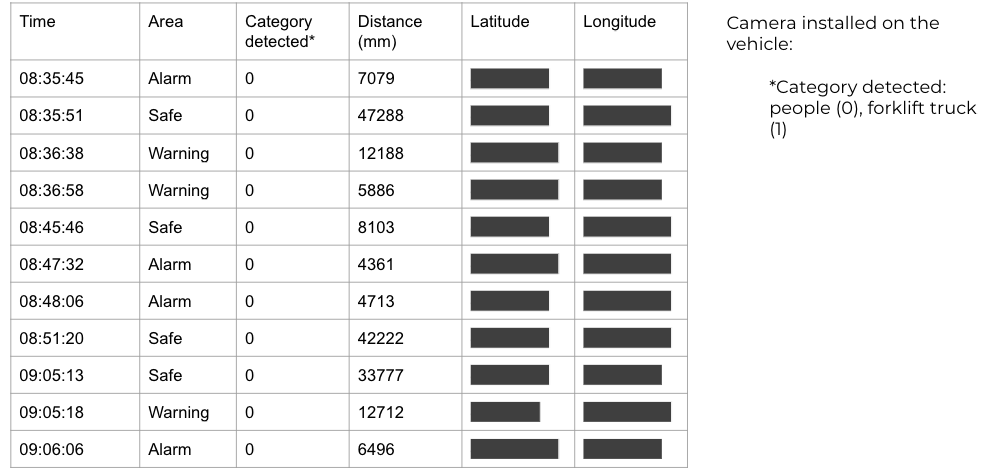

Thanks to a data crossing with the ETS system it is possible to have an overview of how many, where and when all alarms take place, the category of obstacles detected, alarms type and vehicle-obstacle distances (plus in safety mitigation). To sum up, you will be able to identify and control hazards in major areas at risk.
