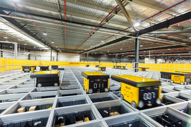

Caterpillar equipment dealer WesTrac has deployed a team of robots, including Cata-picker, Wall-E and Bumblebee, at its new distribution centre in Tomago in the New South Wales Hunter region.
The robots are part of a Dematic automated piece picking system for industrial supplies installed at the warehouse.

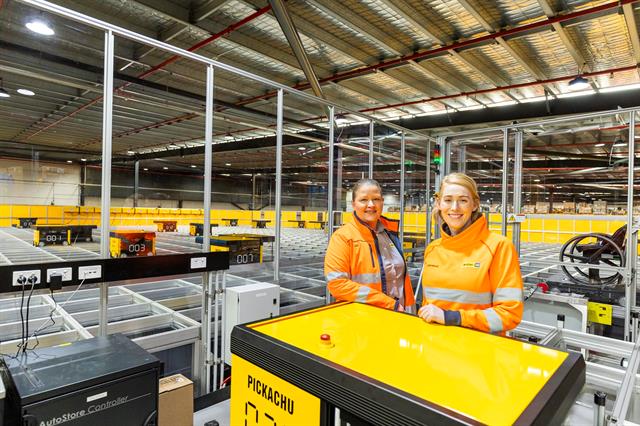

WesTrac ran a competition to name the 24 robots in the system to help identify them.
“The winner of the competition was Cata-picker and some other great names we had were Pickerella, Pickachu, R2D3 and Sir-Picks-A-Lot,” says warehouse supervisor Georgia Denton.

The system features an AutoStore automated storage and goods-to-person (GTP) picking system, powered by intelligent Dematic software.
Urgent orders can be now be completed within five to 10 minutes
It significantly streamlines warehouse operations, with one picker now achieving the work of four to five manual pickers.
The AutoStore system features 15,350 segmented bins, 24 robots, four inbound conveyor ports for replenishing products into the system and six GTP workstations – all designed to optimise space efficiency and accelerate parts distribution.

Seth van Dijk, business development manager at Dematic, explains the system's operation: “When customers place their orders, the WesTrac warehouse management system (WMS) software sends those orders to the Dematic warehouse control system (WCS) software.
“The WCS then directs the robots for maximum efficiency to retrieve all the items needed to fulfil those orders, and the robot delivers those items to the GTP workstations.
“Screens at the workstations instruct WesTrac operators which items to place into the order totes.
“Operators place completed totes on the conveyor, which brings them to a sorter. At the end of the sorter, orders are packed and dispatched for delivery.”
