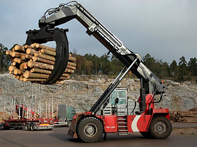

The Kalmar RTD3026 log stacker.
Pasi Rantanen, Kalmar vice president for log stackers, told Forkliftaction.com News the size of the wood handling market was about 400 machines annually. Svetruck is Kalmar's main competitor and both Swedish manufacturers sell 40 to 50 log stackers a year.
Rantanen agreed with Richard that log stackers were not designed to work on non-paved surfaces. Kalmar has been building log stackers since the 1970s. They are purpose-built machines with telescopic booms and hanging grapples that swing sideways and lengthways. Manitou telehandlers can be fitted with rotating grapples but the main differences between the telehandler and the log stacker is the telehandler's rough-terrain ability and lower load capacity. Rantanen said he had never seen a machines like the Manitou MVT 675T telehandler used for loading trunks in Scandinavia and Europe.
He said wheel-loader based log stackers or wheel-loaders with grapples were a very popular equipment choice among forest product companies.
"Volvo is one of the leading manufacturers. It has a market share of 100 to 200 machines a year. However, our log stackers have a bigger capacity than the wheel-loader based log stackers and our transportation features are better, meaning the machines move around more smoothly as they're designed to handle logs. The wheel-loader is basically a wheel-loader with its bucket removed and a log handling system installed."
The Volvo Group's forestry equipment is part of the Volvo Construction Equipment business segment. The group's website said Volvo was a leading global forestry equipment manufacturer for two decades (1960s to 1970s), with forestry equipment constituting a large part of its turnover. However, a decision to focus on the construction equipment sector led to the divestment of its forestry equipment operations in 1977.
Generally, log stacker manufacturers make their own attachments, log clamps or grapples. "It comes from history; we have always done grapples ourselves. It's meeting customers' requirements for grapples that come in different shapes and sizes," Ratanen said.
A Svetruck TMF 15/11 log stacker.
"The main thing in log stackers is that you get a full grapple all the time. The grapple must be full of logs. This does not happen when customers fail to supply clear information about the size, length of log, and whether they are unloading from trucks or railcars and how much they want to get in one pick."
Kalmar does not sell log stackers to the USA because of different wood harvesting techniques.
"We sold a few machines a few years ago to a US company that was handling small trees but the wood was still too long for our machines. Our log stackers are designed to handle cut-to-length wood. In Scandinavia and Europe we get more efficiency by cutting the wood in the forest to suitable lengths. Our grapples could not safely handle the wood length for the US industry, which could be from 20 metres to 60 metres. The Scandinavian technique involves cutting logs five to seven metres long."
