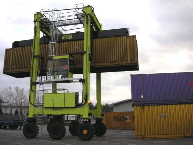

Australian company Isoloader makes straddle carriers for intermodal operations, rather than major port terminals. As such, it competes mainly with manufacturers of forklifts and reach stackers.
"Our straddles are lighter and much more manoeuvrable than standard port straddle carriers," says business development manager Eric Ronco.
Ronco agrees there is little room for newcomers in main port terminals, but "plenty in other operations".
"We are bringing to the market an effective cost and logistics alternative to conventional container handling machines people are used to. On the logistics front, Ronco says Isoloader's straddle carriers offer 50% more stacking density for order picking compared to competitors.
Originally manufacturing to fill a need in the Australian market, the company now has business overseas.
"Last year was a good year for us and 2008 will definitely be better with our development in Europe linked to the development of rail terminals all over Europe," Ronco says.
The Isoloader range of straddle carriers has been developed over the past 30 years, responding to the growing local needs.
"The first Isoloader straddle was developed for the handling of aluminium ingots for a smelter in Australia. Then we developed a solution for handling very few containers a day, the LiftingFrame, then to carry the container around as well, the EconoLifter. Then the customer needed to stack to save space (the Container Handler) and when the customers needed to stack even more and travel fast, the Transporter was born," Ronco says, summarising the company's straddle carrier history.
He names "capital price, running cost and maintenance costs" as Isoloader straddle carriers' edge over competitors and explains that the machines are only competitive to handle full containers.
A LiftingFrame costs AUD65,000 (USD62,504), about 15% of the of a 35-tonne reach stacker. The top-of-the-range three-high Transporter is 10% costlier than an equivalent reach stacker.
"In any case, even with our Transporter, large savings are obtained when considering maintenance and operating costs, which would be at least 30% less," Ronco says. This does not include pavement maintenance as the wheel loading of Isoloader straddle carriers is 15 tonnes maximum, compared to a reach stacker's 60-80 tonnes.
While the straddle carriers are more cost-effective, forklifts and reach stackers are specifically adapted for block stacking operation, typically for loading ships or handling empty container handlers as little or no order picking is required. Straddle carriers are more effective for order picking, Ronco says.
Isoloader is currently working on autosteering, using camera vision. It is also doing its part to improve its green credentials by making its machines more fuel-efficient through energy regeneration when loads are lowered.
