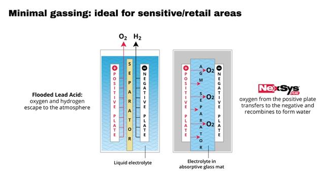

NexSys® PURE batteries also operate with minimal gassing, making them suitable for use in sensitive areas, including hospitals, schools and universities and retail environments. Unlike flooded lead acid batteries that release oxygen and hydrogen, NexSys® PURE batteries transfer oxygen from the positive plate through an Absorbed Glass Mat (AGM) separator and into the negative plate, where it recombines with hydrogen to form water.
A minimal amount of hydrogen is released from NexSys® PURE batteries.

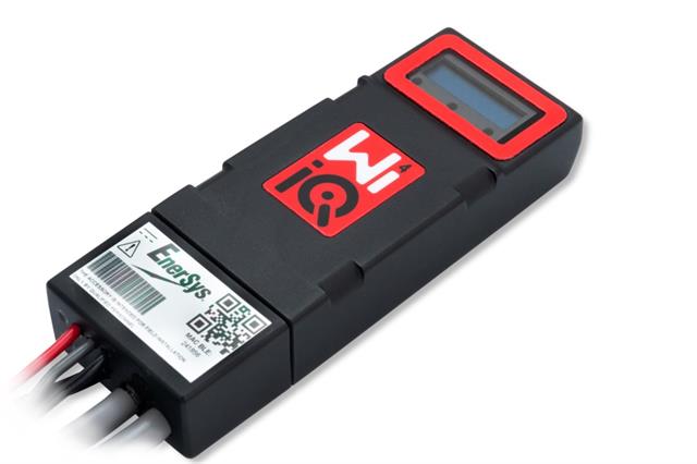

The Wi-iQ® battery monitoring device serves as the first line of uptime defense. Mounted directly on the battery harness, the Wi-iQ device combines battery-monitoring expertise with the latest in wireless communication to monitor and capture essential operating data, including amp-hours charged and discharged, temperature levels, voltage levels and more. When it's time to charge the battery the device issues audible and visible alarms to alert operators.
The Wi-iQ device communicates battery operating data via Bluetooth with a suite of EnerSys® battery operations management tools, including the Truck iQ™ smart battery dashboard, E Connect™ mobile app and the Xinx™ battery operations management system.

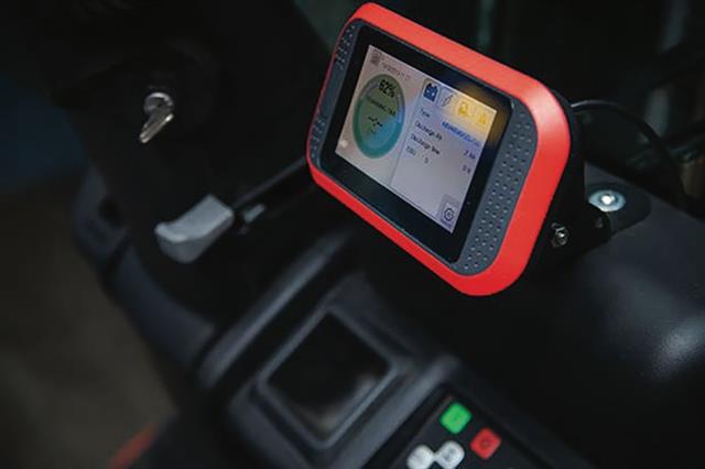

The Truck iQ™ dashboard is a Bluetooth or Controller Area Network (CAN)-enabled display module mounted in the lift truck to give drivers a live view of key battery operating conditions. Featuring a touchscreen display, the Truck iQ™ dashboard is mounted directly on the vehicle for easy viewing and access to a range of alerts and alarms to help optimize battery operation.
