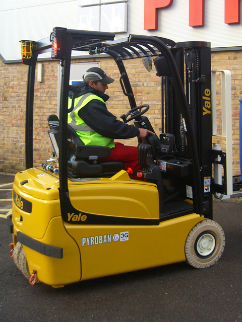

Many companies have updated their site risk assessments and reclassified many of their Zone 1 areas as Zone 2 based on their latest work processes. In response to customer demand and the move towards a Zone 2 philosophy, Pyroban's System 5000 gas protection was designed to protect all brands of both battery electric and diesel engine trucks at minimum cost. Based on the harmonised European standard EN 1755:2000 it is certified to the ATEX 94/9/EC directive by SIRA a leading ATEX certification authority and the technology is constantly evolving with the latest generation of energy efficient forklifts.
Since System 5000 was introduced in 2001, thousands of System 5000 protected trucks have entered service around the world and truck suppliers and users have benefited from its low cost of ownership.
System 5000 also provides the highest level of zone 2 safety. Features include:
  • Gas detection providing visual and audible warnings to the truck operator when gas/vapour is detected at 10% of the LEL (Lower Explosive Limit) of Propane in Air. This allows the truck operator to leave the danger area before an explosive atmosphere becomes present.
  • Automatic truck shutdown at 25% LEL Propane in Air, provides maximum safety to the truck operator and minimum risk to his/her colleagues working in the immediate vicinity. If the operating area becomes explosive the safest course of action is to isolate the truck and its potential ignition sources.
  • After truck automatic shutdown the only person able to restart the truck is the POA (Person in Authority) who can investigate the incident and use the System 5000 master key to restart the truck when the area is free of gas/vapour.
  • Control of access to the protected truck via the System 5000 Operator key
  • Automatic 90 second gas calibration test at truck start up when beginning each day/truck shift. This feature ensures the truck operator knows the heart of the safety system is functioning correctly and keeping him/her safe at work.
  • All sparking and arcing components are contained within restricted breathing enclosures allowing the original truck ergonomics to be retained and safety features such as speed restrictors, weighing devices and lighting to be easily integrated.
  • Temperature limitation to Class T.3 or T.4 to suit the chemical, coatings and pharmaceutical industries. System will provide visual and audible temperature alarms
  • Designed and certified for 95% of hydrocarbon gases and vapours so suited to virtually all applications involving products of Gas Groups IIA and IIB.
  • Plug and Play technology so in event of a failure repairs can be carried out simply and quickly. System 5000 ensures maximum truck uptime for operators.
