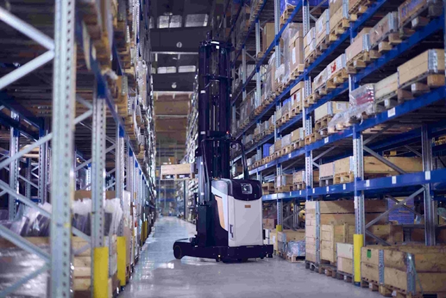

Beyond products like this mini reach AGV, Hangcha is able to help its clients meet the challenges of managing mixed fleets
“Staff need training to work alongside and manage new technology,” adds Zhenyu. “Processes need to be adapted. A gradual journey allows the organisation to learn, adapt, and build internal expertise at a manageable pace, ensuring long-term success.”
