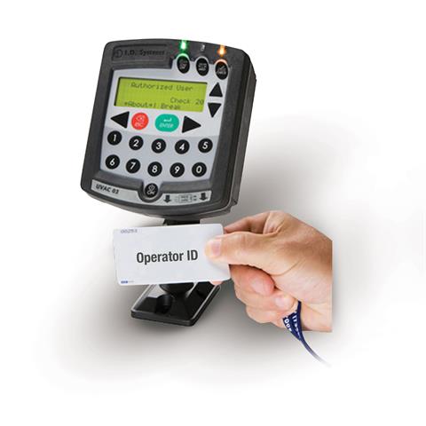

ID PowerFleet
ID PowerFleet

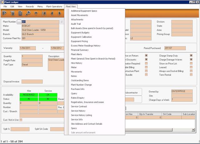

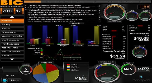

Baseplan fleet management page

ID Systems has partnered with Raymond Corporation to use ID's PowerFleet as part of its iWarehouse fleet optimisation system. The PowerFleet vehicle management system (VMS) works with similar parameters to other systems but can schedule maintenance according to actual vehicle usage rather than by calendar or manual data entry.

Nigel Hammond says Baseplan's IVT (in-van technology) solution is its most popular fleet management system. IVT has been used by Linde Material Handling Australia with impressive results. Linde saw an increase in job productivity from 2.4 service jobs per day per technician to 3.2 within six months of implementing IVT.
