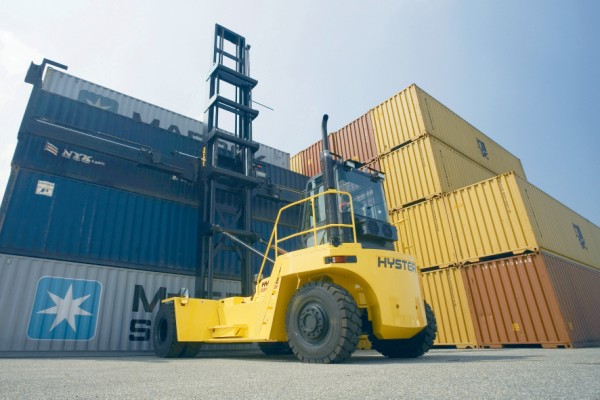

A Hyster empty container handler at work.
Antoon Cooijmans, Hyster Europe's big trucks product manager, says a key development in Hyster's range is the new drive axle on its empty container handlers which he describes as a "major breakthrough for Hyster and the container handling industry".
"This important new development significantly reduces tyre wear and (the) cost for empty container handling operations," he says.
"No other forklift manufacturer has access to this technology in Europe at present," Cooijmans adds.
Hyster Europe currently offers AxleTech International's Xtended Tyre Life (XTL) drive axle on its H16.00-22.00XM-12EC empty container handler series. The company claims it greatly reduces costs for ports and terminals over the vehicle's life.
"Tyre changes on large container handlers are not only costly, but can be time-consuming too as the truck usually has to return to the workshop," Cooijmans explains. "Fewer tyre changes mean less downtime, plus less rubber waste means a better environmental footprint."
The XTL axle has the differential mounted in the wheel ends at each side, enabling the wheels to rotate independently, helping reduce tyre scrubbing. According to Hyster, the typical conical wear of "fixed" twin-tyre sets found on conventional axles is eliminated using the XTL axle as each wheel can rotate independently. This is not expected to interfere with full acceleration and braking power.

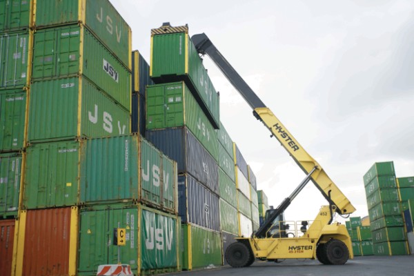

Hyster has also introduced a six-high stacking option for some of its reach stacker models by fitting a longer inner boom. The RS45-31CH, RS46-36CH and RS46-41CH reach stackers can stack 8'6" (2.6 metre) containers six-high in the first container row. New standard features for all reach stacker models include a powered sliding cab for better visibility and a container weight display that enables the driver to anticipate the truck's handling capabilities before the stability and weight limits are reached.
