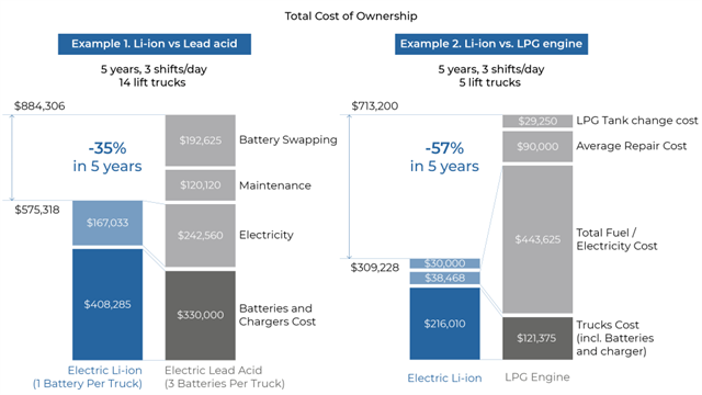

2.  Battery acquisition price vs total cost of ownership
The purchase price of a lead-acid power unit plus charger is lower than a lithium package. However, when switching to lithium you need to take into account the greater uptime provided by single battery operation and the flexible opportunity charging schedule, the 3-fold increase in the battery’s useful life, and lower maintenance costs.
Calculations clearly demonstrate that a lithium-ion battery saves up to 40% in 2–4 years on the total cost of ownership compared to a lead-acid battery.
Among lithium batteries, the LFP lithium battery type is a more economical and efficient choice than NMC lithium batteries.
In most cases, it makes economic sense to switch to Li-ion, even if you operate a small fleet or a single forklift.
