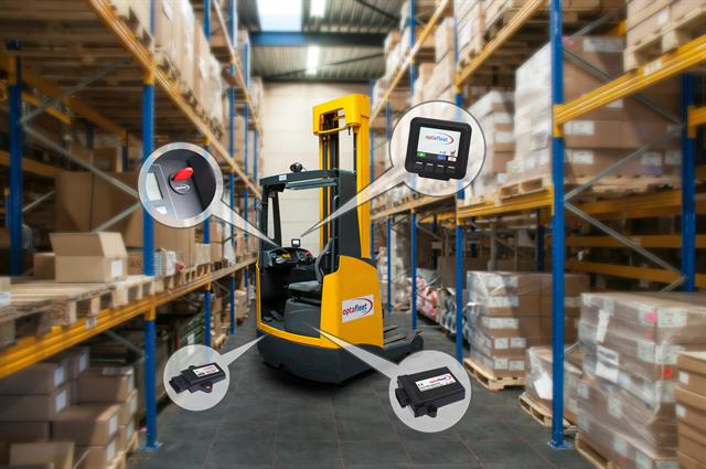

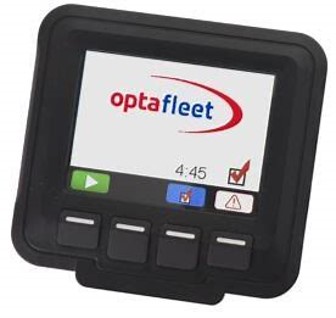

Impco's Optafleet Fleet Management System is designed to provide information about relevant vehicles
According to industry insiders, the effects of the pandemic have been mixed. Impco Technologies, for example, actually experienced growth in the first year of the pandemic (2020), although at a lower level than would have been expected before COVID-19 hit. “2021 was yet another good year, but there again, the semiconductor shortage started to have an impact on sales,” says managing director Serge Vartanian. “This year, we started off very strongly again, but the shortages continue to play an important role.”

Manufactured by Impco Technologies and used in combination with the company’s Optasafe Pedestrian Detection Solutions, the Optafleet Fleet Management System is designed to provide accurate information about what is happening around the immediate vicinity of relevant vehicles.
Where the system is deployed, drivers have access to a monitor and when pedestrians enter nominated zones, an alarm is activated. When this occurs, the truck is reduced to turtle speed and relevant data is transferred to the system.
To improve communication between vehicles and the back end, IoT-based communication using the 4G and 5G (LTE) networks is employed, along with 2G as a fall-back. This new IoT protocol ensures superior penetration into buildings and even basements.

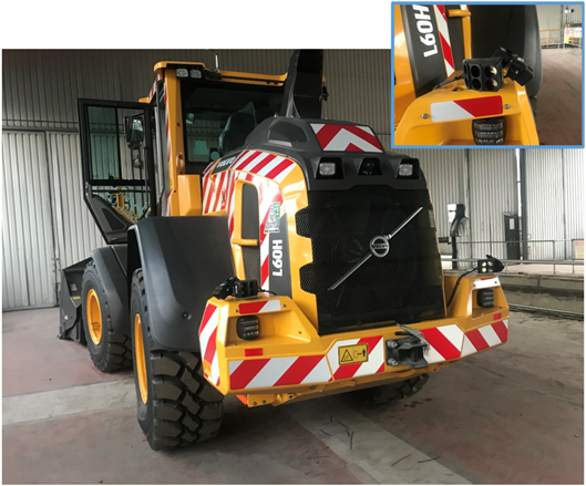

The Transmon ACAS is an all-round solution to forklift safety in warehouse environments
The Transmon Active Collision Avoidance System (ACAS) is an all-round solution to forklift safety in warehouse environments, production areas, loading yards and outside depots. It uses sensors surrounding the vehicle which provide the driver with accurate information about the space behind and to the side of his/her current position. Having this level of visibility significantly increases site safety, provides driver reassurance, and sets the scene for improved performance.

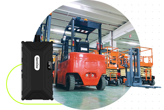

A fleet management solution suitable for mixed industrial fleets and vehicles of all makes and models, GemOne’s Onyx fleet management solution includes several innovations, such as the addition of CAN data, a battery power tracker, and a battery monitoring solution.
The Controller Area Network (or CAN) bus allows the machine's devices to communicate with each other. This CAN data functionality equips businesses with real-time information on the status of their machines, helping them to improve machine safety and boost fleet productivity. For example, it allows management to measure the exact hours a machine is being used and in which locations. This data is available as a live overview on the GemOne Cloud at any time, from any device.

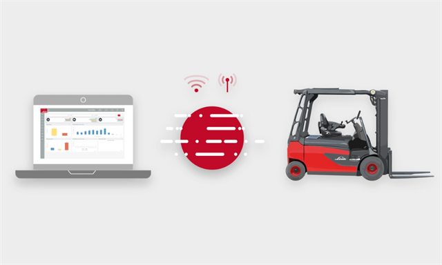

Linde's Fleetfocus includes a dual WI-FI GPRS (3G and 4G) system
An Australian-made and -managed fleet management system launched by Linde Materials Handling in 2007, Fleetfocus includes a range of industry-leading features like a dual WI-FI GPRS (3G and 4G) system which works much like a mobile phone, where depending on the current location of the vehicle, the system can automatically switch between the two; and a display screen saver, which is specifically designed for night use to reduce operator glare.
On top of that, customers are able to temporarily hire units via Linde’s fleet management system, and are invoiced for the time used.

GemOne's Onyx fleet management solution includes several innovations
“Track and trace functionality allows smaller companies to know where each machine in their fleet is located, when it is being operated, and when it is due for maintenance. In this way, smaller companies can eliminate both underuse and overuse of their machines and optimise how they’re using each and every vehicle,” says Patrick Smets, CEO of GemOne.
“For smaller companies with smaller maintenance teams, the insights provided by fleet management solutions ensure businesses can enhance the servicing of machines, both in corrective maintenance as well as in preventative maintenance.”
According to Smets, improved safety is another reason smaller businesses are using fleet management solutions. They make it easy to manage access control so that unauthorised operators are unable to make use of their machinery, and also allow management to track driver and user behaviour. “In this way, they know who has been making use of their machine, for how long, in which way, and where the vehicle is located in real time,” he says.
