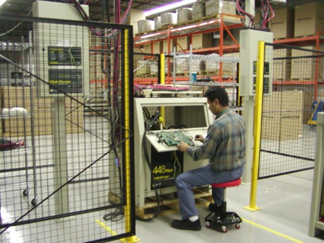

Minit-Charger undergoing pre-shipment <br />testing at the Minit-Charger manufacturing centre.

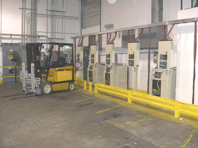

The multi-station Minit Charger system.
Fast chargers are connected directly to battery connectors mounted on the forklift. Recharging occurs quickly because a higher charging current (from 400 amps to 600 amps) is delivered by the fast charger, about three to five times higher than the typical current delivered by conventional charging systems.

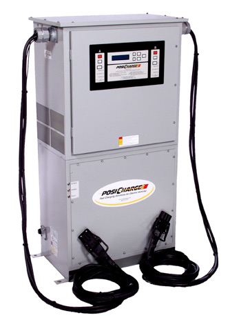

Gid Herman, product manager from PosiCharge, which launched a fast charger in 1999 under the name of its parent company Aero Vironment, said tests had shown fast chargers did not harm batteries.
The Posicharge dual vehicle charger.
"A few years ago, when the technology was just getting started, there were concerns fast charging might be harmful to batteries but numerous audited tests and close collaboration with battery manufacturers has demonstrated that is not the case. Just about every battery manufacturer offers a comparable warranty on its batteries, whether they are fast charged or conventionally charged," Herman said.
