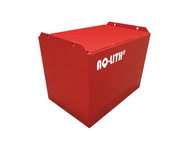

Micha Denys, export sales manager for Battery Supplies, says that end-users have a very wide range of energy solutions available and this has benefits for them. "Each different technology will meet the specific demand as to how the equipment is used, the organisation in the warehouse, the preference of the operator, the environment and the temperature conditions in which the equipment is operating."

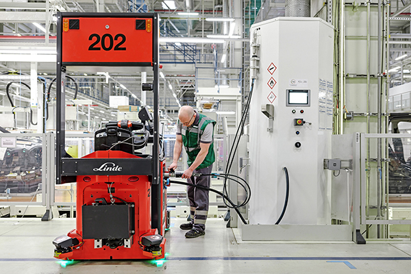

The need for social distancing in workplaces and low contact servicing during COVID-19 has meant an increase in automation and remote diagnostic technology. "Accordingly, end-users are looking for power solutions that require as little maintenance as possible. They also want faster, more flexible charging capabilities, as well as hands-off tools to assess battery condition and performance," says Vanasse. There are a range of remote battery monitoring tools available on the market. The EnerSys Wi-Q battery monitoring device attaches directly to the battery cables communicating with remote sensors on the battery to capture and continuously share vital battery operating data via Bluetooth to other Enersys battery monitoring solutions.

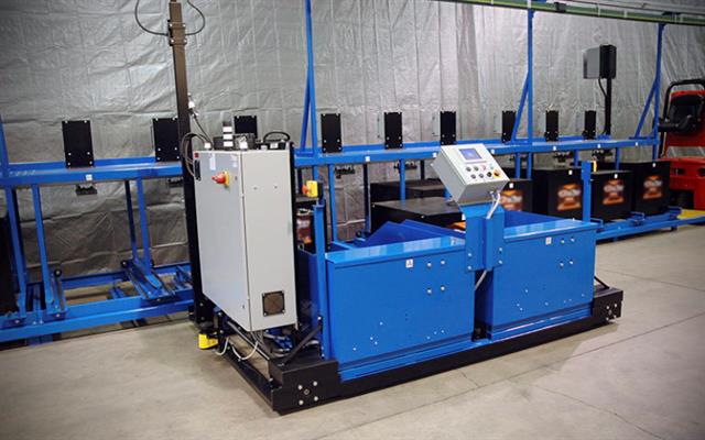

John Lawnton, spokesman for Carney Battery Handling, agrees that COVID-19 has had an impact on workplaces and increased pressure to deliver. "Warehouse space is in high demand as e-commerce has spiralled due to the pandemic. End-users want to automate processes and look for better use of space. Carney Battery Handling has, in addition to automating battery charging, developed a multi-level charging rack to free up warehouse floor space," says Lawnton.

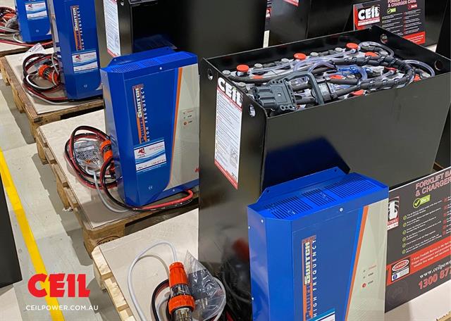

CEIL Power Systems
CEIL Power Systems
David Cooper, CEO of CEIL Power Systems, explains that lithium battery technology is now clearly being viewed as a reliable forklift battery option. Most forklift manufacturers are working towards the ability of their supplied electric forklifts to be operational for both lead acid or lithium battery options. "It is relatively easy to retrofit lithium batteries into any existing lead acid battery powered forklift of any type or brand, but extra measures are needed when retrofitting the batteries to display the relative state of charge and discharged battery communication requirements," he explains.

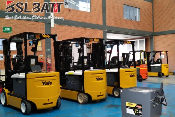

Lithium batteries can be built as a unit or in modules. A battery built in one unit is exposed to higher downtime risks as failure in one component can shut down the entire system. Modularised units like BSL Battery's Lithium Iron Phosphate Battery (LiFePo4) can decrease the risk of complete unit failure. Hugo Chen, chief technology officer for BSL Battery, explains that many customers have specific requirements, so in order to ensure product stability, reliability and versatility, BSL has developed a functional modular component design that disassembles a non-standard product into standard design modules based on functionality. The advantage, says Chen, is that the free combination of standardised products can meet the needs of different customers.
Denys says that Battery Supplies has added an LiFePo4 battery to its range. "This technology is currently a very hot topic in industrial applications. It allows for fast-charging and intermediate charging but also provides the longest possible lifetime of the battery. Although the initial purchasing cost is considerably higher, when taking into account the much longer lifetime of the battery, the customer can easily determine that an LiFePo4 battery is the cheapest, maintenance-free battery solution for forklifts," he adds.

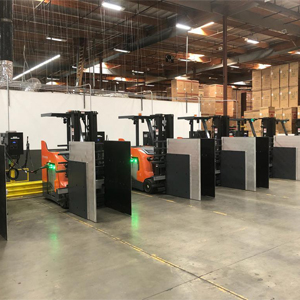

The large forklift market has until recently been unable to access lithium battery technology. Stromcore's head of production innovation, Tamas Pataky, explains: "The larger forklift application market has been dominated by internal combustion engines as they are able to refuel quickly and keep up with the demands of their operations. Stromcore lithium batteries use a premium nickel manganese cobalt (NMC) chemistry which is capable of charging at far higher rates than competing lithium ferrous phosphate (LFP) technologies. Coupled with Stromcore's Turbo Charging technology, batteries can be charged at a continuous 600 A rate, achieving a full charge in under an hour." Pataky adds that by leveraging opportunity charging, Stromcore lithium NMC batteries have the capability to work around the clock in a high-intensity environment with heavy loads.
