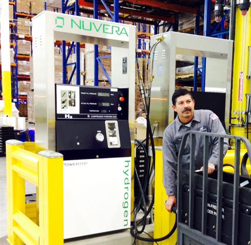

Nuvera at Golden State Foods, Illinois

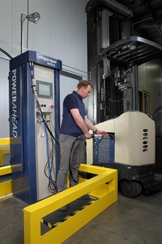

Plug Power GenFuel indoor dispenser

One of the main issues for hydrogen fuel cells has been sourcing, delivering and/or storing of hydrogen for use. Marsh believes that his company has the solution. In conjunction with Walmart, Plug Power developed GenKey - a turnkey solution which helps the customer transition seamlessly to hydrogen fuel cells. With the GenKey solution, Plug Power operates as a single-source vendor - manufacturing, supplying and managing fuel cell units; providing hydrogen storage and dispensing infrastructure and molecules; and supplying aftermarket care and service. Since the implementation of GenKey in 2014, Plug Power have built 10 hydrogen storage and dispensing facilities for FedEx, Walmart, Volkswagen and Honda and has another 15 planned for construction in 2015.
In November 2014, Nuvera delivered a PowerTap-brand on-site hydrogen generator and fuelling station to manufacturer-distributor Golden State Foods Corp at its new regional headquarters and logistics centre in McCook, Illinois. Nuvera says the facility will consume less than 50 kg of hydrogen per day for 39 fuel cell forklifts, including 11 Class 2 stand-up reach trucks and 28 Class 3 rider pallet trucks. Nuvera's PowerTap on-site hydrogen generator converts natural gas and water into 99.995% pure hydrogen. Block says that multiple generators can be used to meet increased demand. The PowerTap system includes the hydrogen generation, compression and storage equipment, all of which is installed on a concrete pad outside the facility. Hydrogen is then piped to fuel dispensers located at convenient points inside. On-site generation of hydrogen eliminates regular hydrogen delivery costs and logistics management, and because hydrogen is used soon after it is generated, less fuel storage is required. For many smaller forklift fleets, on-site generation also makes more economic sense, adds Block.
