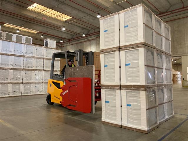

Whether stocking or picking and shipping orders, operations must run at full speed, therefore companies are looking for solutions to carry out handling operations safely while keeping high productivity flows.
To support the logistics chain and in particular the white goods industry sector, the Bolzoni Group has developed specific know-how on appliance and high-volume carton box handling procedures.
Today the Bolzoni Group enlarges its carton clamp proposal with a complete range of integrated features including the most advanced technology in hydraulics, electrics and laser sensors for damage prevention and clamping force controlling.

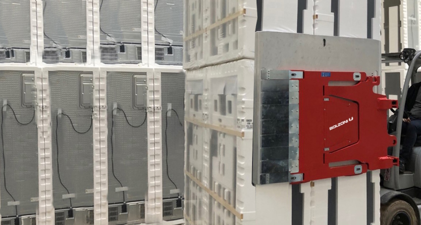

Damage-free carton handling
The white goods industry is characterized by particular challenges, all linked to damage-free load handling. Because of their weight, dimensions and considerable value, home appliances require specific handling practices, mainly linked to the application of the proper clamping pressure, which missuses can lead to considerable goods damage.
Bolzoni is committed in providing certified products and solutions to avoid possible goods damage and is offering a wide range of white goods handling equipment, including intelligent technologies, able to reduce human error.

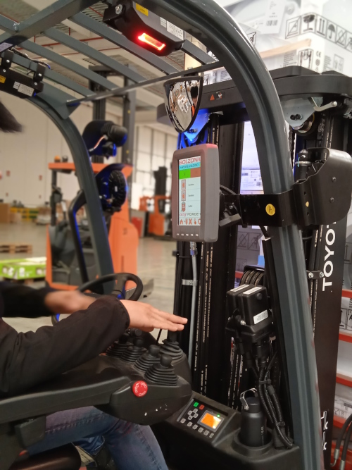

Easy-FORCE-C Pressure Control System with remote handling data management
With a quick selection the system automatically sets the clamping pressure and Fleet Managers have remote control in real time.
Bolzoni Easy-FORCE-C Pressure Control System is specifically designed for big warehousing and logistics industries, where it is required to handle several types of products, optimizing space and time.
Through various levels of selection on the 7" touch screen monitor fitted in the driver cabin, the operator enters the load type and configuration then, with a simple touch of the display, the system automatically sets into the clamp the pressure limit to apply the correct clamping force.
This intelligent system automatically saves frequently used configurations to be quickly re-selected by the driver, optimizing handling operation time.
Easy-FORCE-C offers also much more to companies that are looking for data tracking and remote fleet connection. The system enables geolocalization, data tracking, clamp parameters customization and warnings for maintenance schedule management.
Data are accessible through a web-server interface, in real time accessible to the fleet manager, and can be stored in a database, with encrypted access (https).
Easy-MOVE laser sensor system: the most advanced technology in sensors for clamping force controlling
The Bolzoni Easy-MOVE intelligent system makes handling operations safer thanks to the automatic setting of the correct clamping pressure.
For high level of product differentiation applications, the change in clamping force is a key driver for load damage prevention.
The Bolzoni Easy-MOVE is a completely automatic system driven by a laser sensor and electronic micro control, that can detect load dimensions and input the correct clamping pressure through a proportional pressure relief valve.
"As standard, these clamps are ex-factory preset with load and pressure parameters agreed with the customer," says Vittorio Lucchini. "In case the load handling parameters need to be updated, through an easy procedure with a dedicated tablet, supplied by Bolzoni, the end user can recalibrate the pressure levels. Moreover, in case of introduction of new loading schemes, it is possible to adjust opening range, pressure values, calibrate sensors and finally to switch to single pressure manual mode."

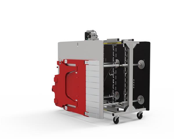

ForceBalance System: the correct clamping force distribution
Bolzoni ForceBalance System makes life easier for every truck driver who wants to grant optimum clamping force and ensures extremely fast operation.
Bolzoni ForceBalance System allows perfect distribution of the clamping force over the pads’ surface thanks to the user-friendly registration of four thread screws that can be easily adjusted to make the clamp perfectly suitable for all specific handling configurations.
By adjusting the four screws, positioned in the four corners of the arm carrier, the clamp reaches the perfect panel protrusion to match the load handling application.
Besides the completely damage free solution granted by the force distribution control, this system keeps the arm profile very thin with tapered leading edge of the conventional clamps.
