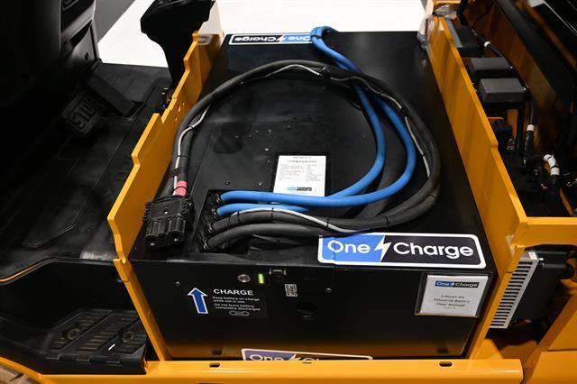

According to Khabur, manufacturers, food and beverage makers, warehousing operations and others are turning to industrial lithium batteries to not only achieve sustainability goals, but also enhance efficiency, overcome labour shortages, and more.
“The benefits of lithium-ion batteries include longer operating time with minimal downtime, improved operations, remote diagnostics and integration into fleet management systems. Lithium batteries are fundamental for AGV and AMR use, which helps to overcome labour shortages and support automation in manufacturing and logistics,” he says.
"As a power source, they (lithium batteries) keep up with the technology available on the forklifts, providing better, cleaner, more stable power, that is safer for the operation, the forklift and the driver."

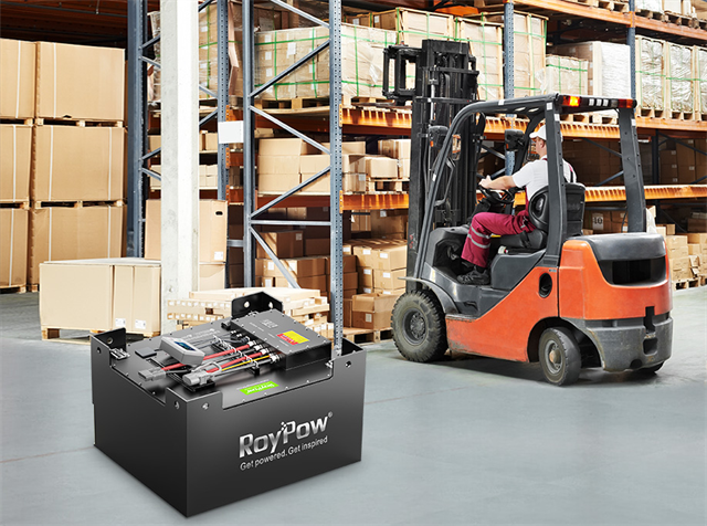

According to Mark D'Amato, sales director of RoyPow USA, another attraction of lithium batteries is the fact that – unlike traditional lead acid alternatives – they contain no dangerous substances (acid, hydrogen during gassing, etc.). They eliminate battery labour costs and end-of-shift charges, and perform effectively in cool room and freezer applications.
Lithium batteries from RoyPow contain no dangerous substances
“As a power source, they keep up with the technology available on the forklifts, providing better, cleaner, more stable power, that is safer for the operation, the forklift and the driver. Overall, they can be relied upon to reduce (their) carbon footprint and ultimately lower the total cost of ownership for many companies,” says D'Amato.
On top of that, he adds, lithium batteries offer a longer service life than their lead acid counterparts. They generally charge in less than two hours and, thanks to their smaller size, they facilitate the installation of narrower aisles in warehouses, and in turn, free up space for extra pallet positions.

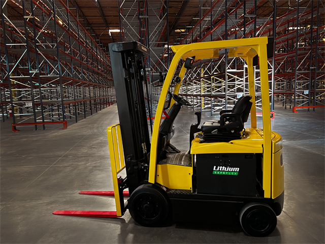

Tri-Lift Industries generally leads with two primary battery options when it comes to electric equipment. “We offer integrated lithium iron phosphate battery technology from BYD and drop-in lithium solutions from Clark forklifts. Between the two offerings, we have been converting companies across a range of industries away from diesel and liquid propane equipment to electric,” says Bond.
LiFePO4 batteries as drop-in replacements

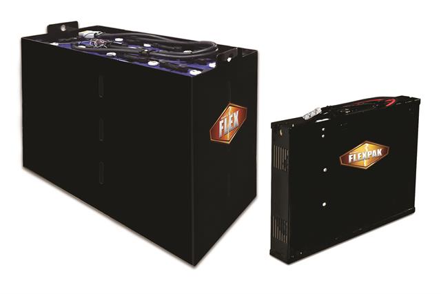

Recognising this, Hawker offers not only lithium batteries but also Thin Plate Pure Lead (TPPL) products, which are a type of absorbed glass mat (AGM) battery.
“The Hawker FLEX TPPL battery is a chemistry we’ve been manufacturing for almost 30 years. The chemistry has been refined to include battery power for forklift applications which delivers the lowest cost benefits in light to medium duty applications,” says Dean Portney, vice president sales and marketing at Hawker.
“Hawker has been successfully satisfying advanced chemistry needs with this chemistry for approximately six years.”
According to Portney, the product shares many characteristics with lithium batteries. It is virtually maintenance-free, doesn’t require changing in most applications, and can be charged at high rates. Easy to use and requiring only low levels of maintenance, it is designed to increase forklift productivity at a lower economic cost.

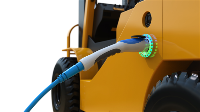

Battery charging options
Delta's MOOVair Wireless Charging System delivers important safety benefits

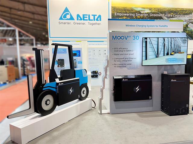

According to Alistair Coltart, director of Delta Industrial Battery Charging Solutions, the introduction of lithium-ion batteries has also improved the efficiency of charging.
Unlike lead acid batteries, which “are typically taken out of the vehicle and charged in a separate battery charging room”, lithium-ion batteries can be charged very quickly. This makes opportunity charging – the practice of charging batteries in short bursts, and at convenient times – possible.
“These benefits could be multiplied as wireless charging technologies become mature, so the end user does not even have to manually plug the charger in which saves manpower and can run 24/7 compared to traditional wired charging,” says Coltart.
Products like Delta’s MOOVair Wireless Charging System also deliver important safety benefits. They solve the problem of having to safely remove bulky batteries (weighing 200 kg – 2,000 kg) without leaking sulphuric acid; and they eliminate the ‘gassing phase’, which requires effective ventilation in charging rooms and can potentially cause fire.
“The combination of lithium-ion batteries and wireless charging reduces maintenance time and achieves convenient and autonomous logistics for end-users,” says Coltart.
“When adopting wireless charging into a fleet of forklifts, the ‘old school’ charging methods are thrown out as there is no longer the need to disconnect the battery from the vehicle, remove the battery and take it to a battery room for charging.
“If the vehicles are manually driven, then the only important criteria for charging wirelessly is to make sure the charging pads are aligned correctly. This means a little careful driving, but saves a lot of the dangerous manual work involved in ‘old school’ charging.”
"On-board charging provides a better solution to the operational demands and challenges experienced by large warehouses, material handlers, and rental fleets."

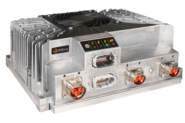

On-board charging
According to Delta-Q Technologies, the smaller size of lithium-ion batteries makes on-board charging possible
The smaller size of lithium-ion batteries also creates enough space on forklifts for robust on-board charging solutions.
“On-board charging provides a better solution to the operational demands and challenges experienced by large warehouses, material handlers, and rental fleets. These applications allow forklift OEMs to improve their overall systems significantly and eliminate the need for external battery charging,” explains Rod Dayrit, Delta-Q Technologies’ director of business development, USA.
In addition to freeing up space and reducing costs, on-board chargers also simplify the task of integrating the battery and charger with telematics and CANbus systems, and provide fleet managers with access to insightful fleet management data.
“Telematics enables fleet managers to monitor battery and charger health and performance, which helps them prevent costly repair or service calls by identifying poor battery charge management. These capabilities allow for preventative maintenance that helps OEMs enforce warranty claims and enhance user interfaces and experiences,” says Dayrit.
Emphasising the benefits of opportunity charging, he says that the on-board charger also eliminates the burden of setting up the charger and attaching the battery when recharging the machine, which provides more flexibility so that forklift operators can charge wherever there’s an AC source, on breaks, or between shifts.
