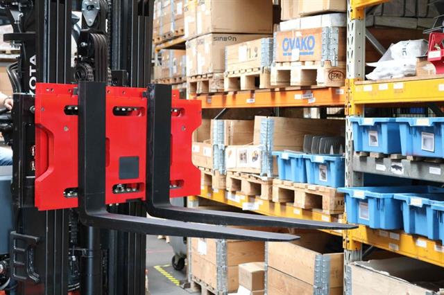

The iCP allows you to weigh material at the pallet's location by simply lifting the pallet a few inches off the ground. While lifting the pallet, you collect real-time data directly onto your RAVAS indicator or via the RAVAS WeightsApp, which can immediately push the data to your ERP or WMS business system. Thus, providing your associates with fast real-time data to manage. The iCP also helps to avoid overloading a trailer, which prevents unnecessary costs.

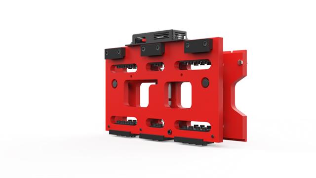

The iCP carriage plate scale allows you to weigh loads that are handled by forklift attachments like rotators and clamps. This enables applications where materials are dosed from the truck based on weight, by pouring them from containers or vessels. For foundry applications there is a special version of the iCP, with added protection for cables and electronics, to prevent damage from heat radiation. The iCP can also be certified legal for trade, allowing users to invoice their customers based on weight. This makes it an ideal product for applications in the recycling and waste removal industry.
Features of the iCP

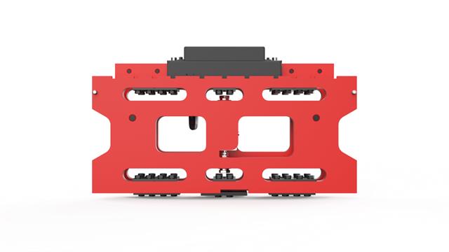

Durability
The multiple flexures absorb the constant shock of load-bearing while transferring the weight to the load cells. These critical elements have no moving parts, reducing the potential for failure.

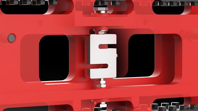

Accuracy
The iCP has a single tension load cell with 0.1% accuracy. The unique single load cell design provides superior load-sample linearity, as well as maintaining both heel-to-toe and fork-to-fork accuracy.

The iCP attaches to most forklift carriages and requires no modification to the forklift as it does not connect to the truck's hydraulic system. As a result, lifting, weighing, counting, accumulating and transporting are accomplished as a single efficient operation. This streamlines workflow by eliminating the time-consuming task of taking shipments to remote platform scales.

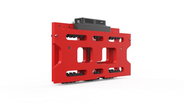

Standard specifications
  • Weighing capacity: 2,500, 5,000 of 7,000 kg
  • System tolerance: 0.2% of the load lifted
  • Overload protection: 200% on mechanical construction
  • Protection class: IP65/NEMA 4
