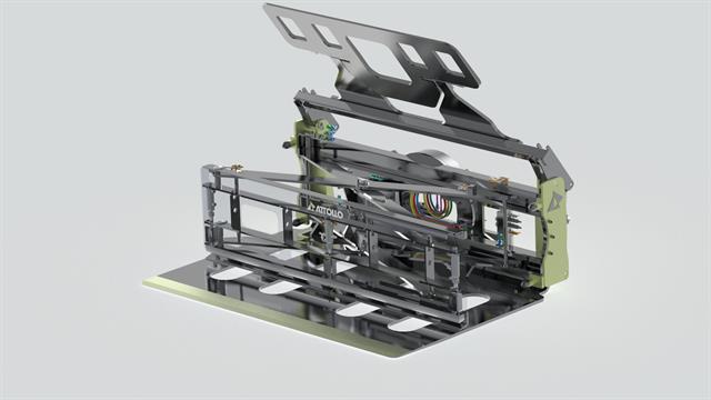

The new forklift attachment is a 'rotating dual push-pull clamp'. The attachment is powered hydraulically from the lift truck, and, due to the required multiple functions of the attachment, it does require an electrical switch/solenoid to split/share one of the hydraulic functions powered by the lift truck.
The finished attachment weighs approx. 1,500kg and mounts directly to the lift truck's ITA Class 2 mount. It features a quick-disconnect mount for ease of removal to another lift truck if required. The physical dimensions are 2,150mm (w) x 814mm (h) x 1,700mm (d), and the attachment has a capacity rating of 500kg @ 500mm load centre.

In comparison to traditional lift truck attachments, the internal hydraulics of the attachment are complicated due to the following functional requirements:
  1. The rotational feature is driven via a gear box and an oil motor.
  2. The push/pull feature is entirely cylinder-driven and incorporates a sequence valve that, depending on cylinder stroke, will alternate the push/pull function. The slip-sheet gripper is controlled through specific pressure settings to enable control of two physical functions with a single hydraulic function.
  3. The clamp function is also cylinder-driven and includes a specific pressure setting via cross-port relief. This is included to ensure there is no product (fridge) damage, in conjunction with a load-holding or counterbalance valve to ensure the fridge can't be released during rotation.
