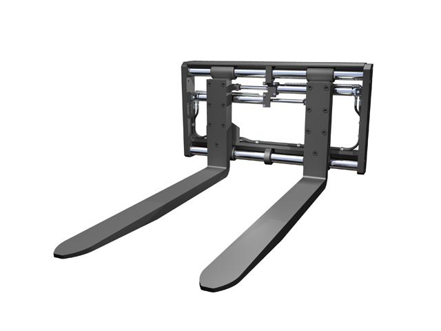

The second product, the iFEXS or integrated fork position with extra stability, focuses on safety, as well as improved efficiency. The iFEXS is a unique double-axle sideshift attachment, with axles at the top as well as the bottom, which can both clamp and sideshift the load. It was specifically designed in response to requests from heavy industry. Bo Dissing, head of development, explains that heavy industry clients had requested an attachment which could offer stability under extreme conditions, while clamping and shifting a load of up to 8 tons.

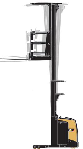

Driver safety in particular, appears to have been the main stimulus for many of the recent technologies. Cat Lift Trucks, for example, recently won the FLTA award for Ergonomics with its Active Sway Control (ASC), a software application that minimises sway by automatically controlling acceleration and braking, ensuring the driver's compartment remains stable at all heights. Monica Escutia, marketing spokesperson for Cat Lift Trucks, says that "mast sway on high-level order picks can be up to 20cm between forward and backward pitch. Each time the mast sways between moves, the operator must wait up to 10 seconds before they can safely carry out the pick". She adds that "the ASC can improve driver comfort by eliminating the motion sensation that can sometimes disorient operators, so they remain alert and focused at all times".

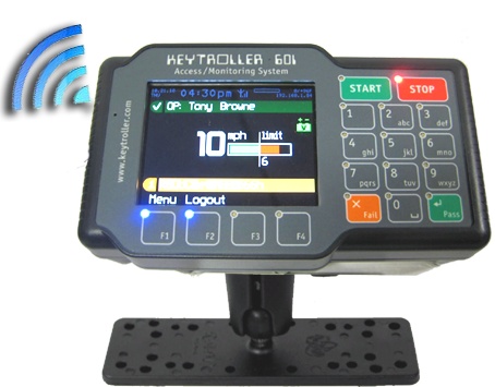

Safety monitoring systems manufacturer, Keytroller's access monitoring systems have been using RFID technology since the 1990s to monitor and record operator usage, utilise keyless technology and monitor maintenance schedules and alert operators to maintenance issues. The new LCD-601 device, launched last year, does all this, but is also designed for tough outdoor conditions and uses a colour LCD screen, a larger and faster microprocessor, allowing for the development of new features through firmware enhancements, plus an embedded WiFi radio, allowing all the features to be fully automated.

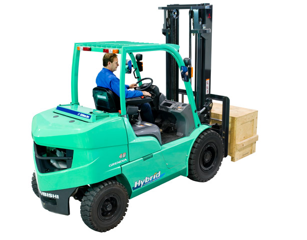

Mitsubishi Heavy Industries (MHI) will also showcase hybrid technology at this year's CeMat with its "world's first" lithium-ion-battery/diesel-engine 4.0-5.0 ton forklift series. MHI believes its unique powertrain design of high-capacity lithium-ion battery: a compact, low emission diesel engine, two induction motors and an inverter will cut engine displacement by one third and significantly reduce CO2 emissions, whilst demonstrating a 39% increase in fuel efficiency.

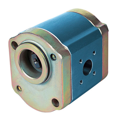

German manufacturer Haldex Hydraulics has recognised the need by developing a new super-quiet gear pump, the CALMA. The CALMA reduces noise by up to 10dB or 50% to 85% in low speed applications, including steer, tilt and lift. The pump features a newly engineered tooth geometry and innovative true dual-flank gear engagement which reduces pressure pulsation by up to 75%, the key factor to determining a pump's noise levels.
