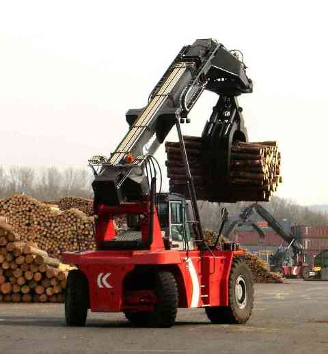

Kalmar has launched a new generation of log stacker, the RTD1623, to replace the RTD1523, which has been on the market since the early 1990s. Compared to its predecessor, the new RTD1623 offers more capacity, increased stability and even better manoeuvrability, despite having a wheel base 250mm longer.
The new machine incorporates many of the proven and popular features of its predecessors, the RTD1523 and RTD3026 models, but also offers a number of new developments.

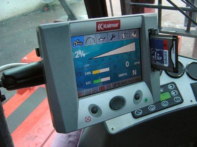

Integrated graphic user interface with colour display:
An integrated computer displays all of the machine functions, warnings and alarms, as well as allowing adjustment to be made to the log stacker's parameters, properties and functions. The multi-page graphic settings screen features operator, service technician and factory levels, all with different access rights.

The RTD1623 is equipped with new low-profile 35/65 R33 front tyres with extremely wide footsteps. These ensure excellent traction in all conditions as well as being stable during complex manoeuvring. Single tyres, at 3710mm, were selected to keep the log stacker's width within reasonable limits. The tyre width plays an important role in stacking efficiency, especially when dealing with short logs.
New single cylinder steering axle:
The RTD1623's steering axle construction is totally new, consisting of a single vertical plate to which the hydraulic cylinder is attached. The piston rods of the steering cylinder are well protected against damage from external particles.

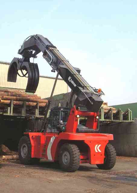

Wide range of grapples available:
The new model comes with a 4.8m² grapple as standard, although customers can opt for grapples of between 3.0m² and 7.0m². Kalmar has traditionally engineered the grapple according to the requirements of the individual customer.
Well adapted for sawmill operations:
Busy sawmill operations are very demanding. After picking logs from the sorting line, it is necessary to level the log ends by pushing them lengthwise against a concrete wall. The customer can opt for a grapple equipped with tilt suspension in order to protect the log stacker's steel structure against extreme shocks. For additional protection, the grapple hangs free at speeds below 3km/h, unless it is force-tilted hydraulically.
Optional boom suspension for a smoother ride:
To ensure a smooth drive, customers can opt for lift cylinders equipped with hydro-pneumatic accumulators designed to ensure better suspension, especially useful in terminals with rough ground. The suspension stabilises the ride and effectively reduces the shocks and boom movements, thus eliminating high stress peaks in the structures.
