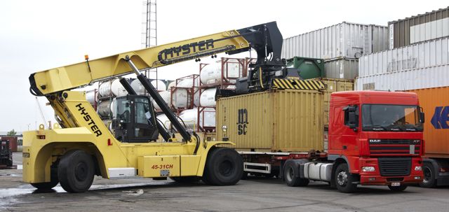

A new Hyster reach stacker is using significantly less fuel than its competitor in a container terminal operation in the Benelux region.
The six-month test by an "independent user" shows that the 45-31CH Hyster is using up to 5.7 l (1.3 gal.) less fuel compared to a competitor reach stacker. The Hyster has a Cummins QSL9 (370 hp./ 276 kW) diesel engine that meets the requirements of Tier 4 interim, Stage IIIB emissions regulations.
Hyster Big Trucks global product strategy manager Jan-Willem van den Brand says: "We have told the market that it is possible to achieve up to 20% fuel savings and this data from a busy terminal proves our claims. This is not theoretical; the savings are visible at the pump and in the reduced frequency of refuelling."
Data analysis by Hyster shows the Hyster reach stacker using 18.8 l (5 gal.) per hour, compared with competitor brands which are using 24.5 l (6.5 gal.) of fuel per hour while performing identical work over similar shift patterns. This equates to about 23% in savings.
A representative from the undisclosed terminal says they believe they could save about EUR60,000 (USD76,983) a year if they were to replace all seven reach stackers at the terminal with the new Hyster reach stacker."
