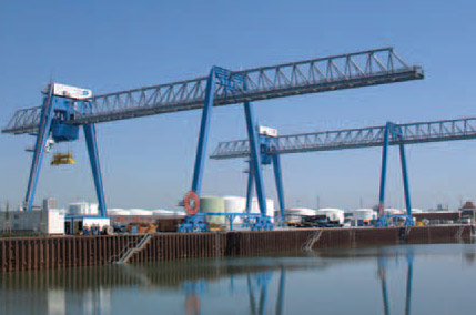

Gottwald WSGs at Triport, Port of Ludwigshafen, Germany
Gottwald Port Technology has delivered five wide span gantry (WSG) cranes to Busto Arsizio-Gallarate rail terminal near Milan in Italy, operated by the Swiss combined transport operator Hupac.
The five cranes of identical design are double-rail WSGs that perform the same tasks as the terminal's existing KSR and Aumund cranes. The cranes have a span width of 38 metres and are equipped with nine metre long cantilever arms.
The lifting height is 12.8 metres, enabling one-over-three container handling. The lifting capacity on the ropes is 57 tonnes while the telescopic spreader will allow 41 tonne loads to be moved. The cranes travel at 140 metres a minute and cargo is raised and lowered at up to 30 metres a minute.
