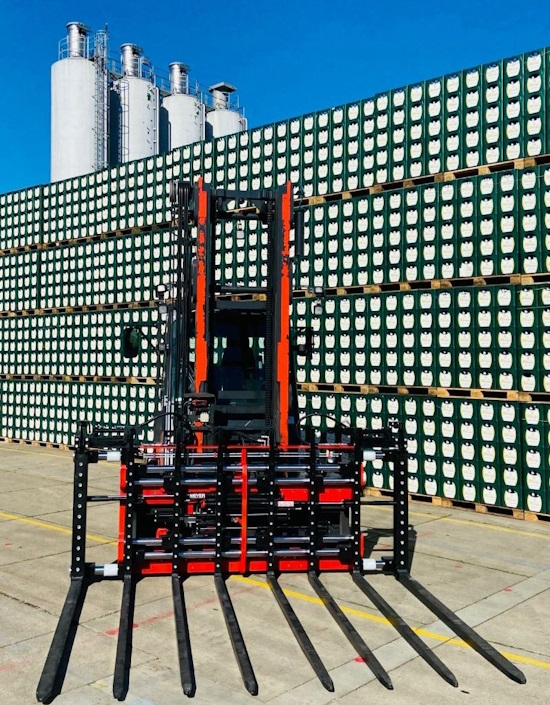

In the Food & Beverage industry one of the most significant trends is undoubtedly sustainability. How can we effectively reduce the environmental impact when transporting and handling pallets in yards and storages? Can a forklift truck’s attachment have an effect?
The multi pallet handler represents an environmentally friendly device in several ways.
The multi pallet handlers can effectively and simultaneously handle up to 8 pallets at a time. This alone reduces the overall number of required journeys to transport loads, to automatically decreases CO2 emissions and to get lower fuel consumption. In facts, this attachment enables efficient goods stacking, maximizing loading capacity and reducing the total number of vehicles used for distribution.
From the standard 2 or 1 pallet handler to the more advanced models able to manage up to 8 pallets at a time, this forklift truck attachment represents the best solution to meet the logistical challenges, including sustainable and fast handling.
Thanks to their ability to handle heavy loads and to adapt to different pallet sizes, multi pallet handlers have become an indispensable tool for companies operating in the Food & Beverage industry, reducing loading and unloading times and optimizing space in production plants and warehouses.
Whether it is to handle 2/1 pallet, or up to 8/6 pallets at a time, MEYER multi pallet handlers help to reduce the maneuvers required and improve overall efficiency.
MEYER: the excellence in multi pallet handling
Specific handling solutions, dedicated to the Food & Beverage Industry, are provided in a wide range of MEYER multi pallet handlers.
MEYER Multiple Pallet Handler are being used in all industries characterized by heavy handling of palletized loads and in particular in soft drink industries, breweries, mineral water bottling plants as well as in brick industries.
Designed for handling multiple pallets simultaneously, the MEYER multiple pallet handlers can dramatically reduce the number of working cycles, increasing the productivity and reducing costs during storage or loading and unloading of vehicles.

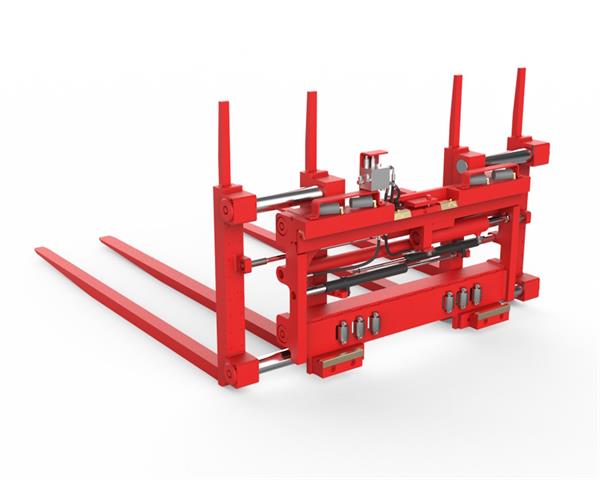

The new MEYER 4/2 pallet handler: model 6-54 full-service G Series
Recently showcased at LogiMAT 2024, the new MEYER 4/2 pallet handler, model 6-54 G series, represents a groundbreaking advancement in logistics efficiency.
This innovative solution not only ensures optimal life cycle cost management but also significantly reduces downtime and maintenance expenses. By seamlessly integrating the fully encapsulated MEYER Shaft Guide Concept with the newly optimized Full-Service sideshift, this pallet handler sets a new industry standard. Its innovative features, including the overhead cylinder for enhanced safety, lateral force absorption capabilities, and wear-resistant slides, contribute to its exceptional performance and extended lifespan.
MEYER pallet handler provides an optimum visibility and clean working environment through the unique encapsulated Shaft Guide concept.
Reduction of downtime in Logistic and maintenance costs
The reduction of downtime in Logistic and maintenance costs is possible, thanks to the combination of the unique shaft guided system and the new service optimized sideshift concept.
The encapsulated Shaft Guide Concept combines precision-machined and hard-chromed shafts with encapsulated high-performance bushings. These components allow for up to 1,000 working hours between greasing intervals. Additionally, the system features auto-lubrication to further extend the life of the wear slides, and the encapsulated rollers are greased for life, eliminating the need for maintenance. This design ensures efficient operation with minimal maintenance requirements.
The lower roller support is made of durable, corrosion-resistant material and is lubricated for its entire lifespan.
