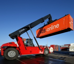

A Kalmar DRG450 variant.
Associated British Ports' (ABP) Port of Immingham has increased its fleet of reach stackers with the addition of a new Kalmar model DRG450-70S5X worth more than GBP330,000 (USD513,795). The machine was shipped to Immingham direct from the Kalmar assembly plant in Poland for use at Immingham Container Terminal (ICT).

The new machine has a 7 m wheelbase and weighs around 90 T. It stacks 5-high under toplift in the first row. The 'X' suffix means that the machine has a more massive counterweight, bigger tyres and rims (18.00-33) and heavy-duty drive and steer axle components.
