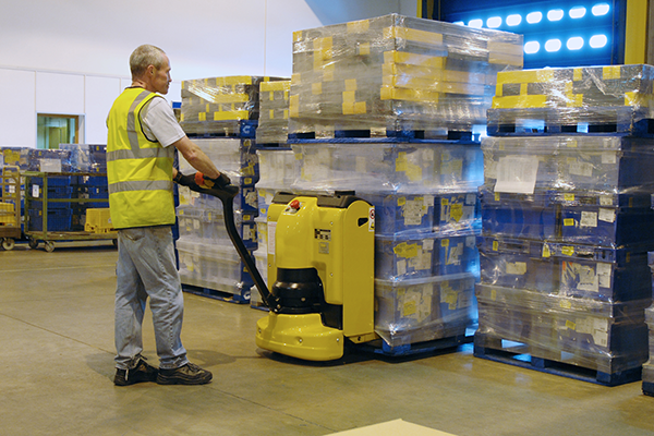

Myth #1: PPT operation involves little to no risk
Many people believe there is little risk involved with the use of pallet trucks. Perhaps this is related to their appearance. PPTs are smaller than other lift trucks, have no cab and can be controlled by the operator walking beside the truck using a tiller arm. Or, perhaps people are more comfortable with them because they sometimes see them, even share the same aisle space with them, when they go shopping.
Nevertheless, however commonplace, the truth is that PPTs can soon cause serious accidents and costly damage in untrained hands. Though smaller in size than counterbalance and reach trucks, they too can cause life-changing injuries if used incorrectly.
Unsafe PPT operation often causes injuries to lower limbs. Pedestrian varieties can inadvertently contact lower legs or be pulled over feet and toes, causing operators serious crush or entrapment injuries under the truck.
Indeed, in recent years, a leading retailer was fined GBP1million (USD1.3 million) when an operator fractured every toe on one foot after an accident in which an electric-powered pallet truck rolled backwards over it.
The assumption that pallet trucks pose little to no risk must be addressed throughout the workforce, for the good of your team and your business.
Myth #2: There is little difference between one pallet truck and the next
Another issue arises from a lack of understanding about the variations of pallet trucks on the market (and their associated categorisation). Generally speaking there is little awareness of the vast range available and, as a result, similar looking trucks can be pigeonholed as one and the same.
Yet with each make and model having varied controls, components and functions, misidentification can mean inadvertently overlooking hazards unique to a specific variant.
There are pedestrian, rider and flip down platform variants, and all with varying purposes and a range of power sources. A good understanding of these variations will help ensure that you don’t fall foul of another common myth – that being trained on one type qualifies you to operate them all.
To help ensure the provision of relevant training for the many variants, pallet trucks are grouped into standardised categories by the Accrediting Bodies Association (ABA). Training on each category needs to include specific features which may not be relevant to another variant so, for the safety of your operations, understanding these groupings (and therefore which trucks your operators are qualified to use) is vital.
