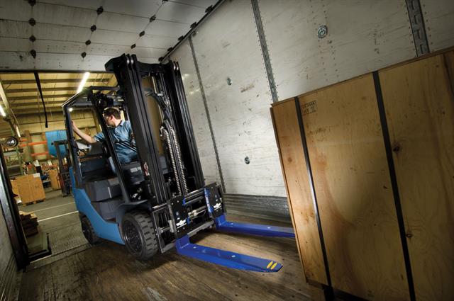

Combining transport and weighing into one easy and efficient step results in shorter cycle times, saving both time and money. Cascade iForks are a unique and innovative mobile weighing solution that lets you determine the load weight while the product is still on the forks, eliminating the extra step of driving the product to a fixed floor scale.

The iForks system allows drivers to view and track the weight of individual loads, total weight of multiple loads and number of individual loads within a load. iForks are the first completely wireless mobile weighing system for forklift trucks in the world, as a result of the integrated Bluetooth technology. Being wireless, the system can be installed onto any forklift in a matter of minutes.
Each fork is equipped with its own battery module, eliminating cable reels and power cords between the forks. The battery modules are exchangeable, robust and integrated into the fork design. The bulky housings for battery and electronics on top of the forks are no longer necessary.
The Bluetooth transmitters and calibration board have been integrated into the forks to avoid the risk of being damaged, this makes downtime on the iForks Pro extremely low. Both scale forks communicate independently with the driver display in the truck cabin, each via its own Bluetooth signal.
The iForks Pro install easily, even on forklift trucks with a load backrest above the carriage. Cascade also offers NTEP certified (Legal-for-Trade) models as well as Logistics iForks with thinner fork profiles specifically designed for use in applications that have a low entry height, including the side openings of GMA pallets.
