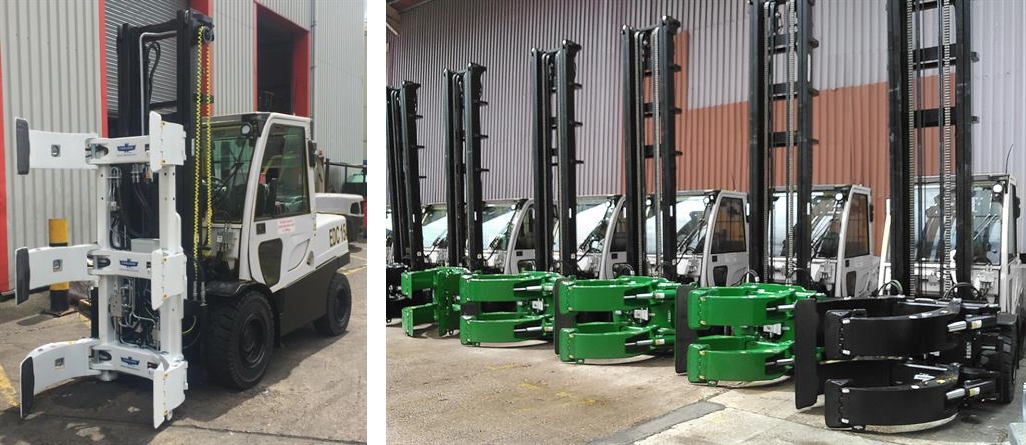

Left: Cascade Tower Roll Clamp          Right: Cascade 42H Paper Roll Clamps

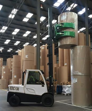

The Solution
Cascade's Engineering department boasts a global team, meaning a unique challenge such as this dual-clamp project can receive intensive, around-the-clock attention. What they came up with was a clever hydraulics feature that brings the capabilities of two paper roll clamps into one attachment. This innovative solution offers two distinct ranges of clamp force. The first stage applies the required amount of clamp force for handling heavy, large diameter paper rolls. The second stage applies a lower clamp force, allowing for ideal handling of more delicate paper types and smaller roll sizes. Integrated with Cascade's popular damage reduction system, Hydraulic Force Control, it automatically applies the correct clamp force for any paper roll without driver input, removing guesswork from load handling and minimizing product damage. With this system installed, operation is fast and drivers are flexible in the sizes of paper rolls they can handle from a single truck.
Beyond this central innovation that doubled the paper roll clamps' utility, Cascade's team also successfully delivered on the rest of the customer's requests. Clamps were outfitted with indicator lights to inform drivers when the clamp arms were fully open or fully clamped. Operation was designed for maximum ease of use and high efficiency, including hydraulic optimization for fast-moving arms.
