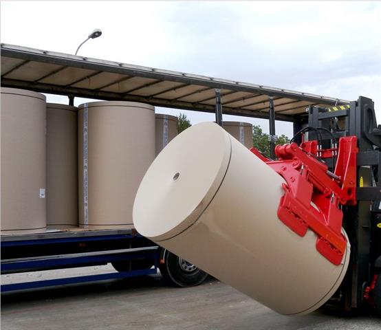

Tilting paper roll clamp, for horizontal and vertical handling.

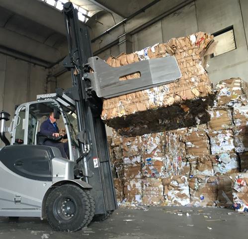

Waste paper bale handling.

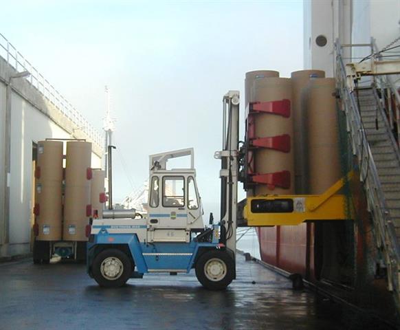

Heavy harbour roll handling

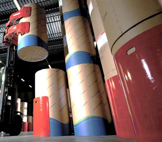

Corner guards to protect rolls near aisles.

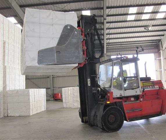

Heavy pulp bale handling.
