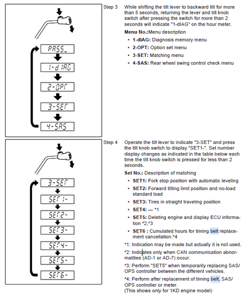

After replacing a damaged multi-function display we are now getting fault code AD-7. We can install the old display and the code disappears. The service manual clearly states that a "Engine and display ECU information clear" is required, nowhere in the service manual does it explain how to perform the procedure. Any advice or help would be greatly appreciated.

For clear this error code AD_7
You should pass in to monitor panel and go to settings 5- and clear it.
In Toyota shop manual book you can see it.

forgot to mention if your old display works go into option set mode and write down how options are set then install new display and set to the same

hope this helps, but make sure the two black relays in the fuse box are working correctly, then you must enter into the option set mode and set options to factory ordered specifications
